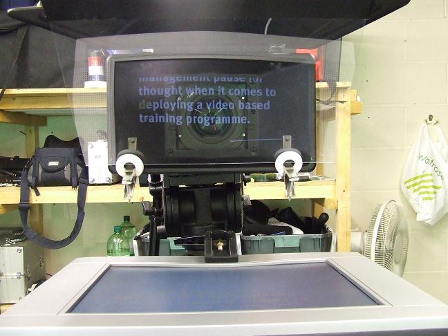

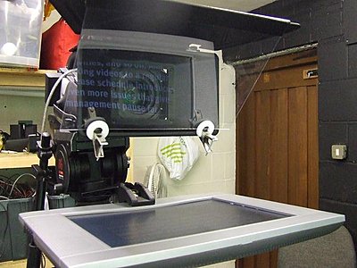

To meet the requirements of a few of my clients, I have rigged up a teleprompt system with an old matte box, an old laptop, an old lcd screen, an A4 sheet of 1mm perspex (from a £1 photo frame), some gaffer tape, some teleprompter software I have had for years and a dash of (someone else's) ingenuity.
It does a remarkably good job and because it's built around the matte box, it doesn't look too bad either. My clients think it is 'well used' rather than a jury-rigged penny-pinching creation! It will only ever be used in the studio when I'm shooting against a green screen. I'm losing about 1/2 a stop, which is quite tolerable.
The one thing that's missing is a way of remotely controlling the teleprompt software, which can be done either using mouse buttons or (more effectively) the arrow keys.
I have looked at many of the available remote controllers but they are just too big and have waaay too many buttons on them for my clients to accidentally press. Is there anything like a simple two, three or four programmable button remote controller available, ideally wireless?
Failing that, I may try with a wireless mini laptop mouse.
Thanks for any advice.

After a little more research and a pre-sales support email I discover that 'Prompt!' from this site www.movieclip.biz works perfectly with most presentation remote controls designed for use with PowerPoint. I bought the Kensington Si600, although I paid a bit more than Amazon is selling it for in the UK :-( Kensington Si600 . I'm also having fun upsetting my four cats with the laser pointer.
I've used it very successfully with the free version of Prompt! and I have to say I am SO happy with the results I'm getting from this. As I mentioned before, my clients think this is what ALL autocue's look like!
Thanks for everyone's suggestions.
By the way, I also looked at another great looking browser-based teleprompter that has been discussed in this forum : EasyPrompter - Portable Standalone Version: the best free OFFLINE teleprompter. . I was about to commit to using that because it can be controlled with the scroll wheel on a wireless mouse but I had some problems with formatting large imported text files in reverse. It was fine with text typed straight in, but who has the time . . . ? I still recommend people take a look at this app though, as it looks extremely good.
Here are a couple of snaps of my setup. I've lost the croc clips and I am waiting for delivery of a slightly sturdier piece of perspex sheet (the sheet shown here bends easily and distorts the text a bit). I was a bit concerned about light reflecting off the perspex but it hasn't proved to be an issue.
Teleprompt/Autocue - remote control question-teleprompter1.jpg   Teleprompt/Autocue - remote control question-teleprompter2.jpg
