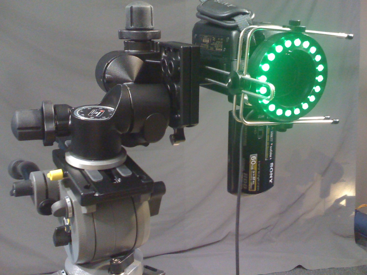

I have the SR11 and have shot a few tests. One thing that's worth mentioning, well two, things. Make that three....
1) If you're shooting people tilt the camera sideways to get more resolution. Most people are tall and skinny :)
2) Consider the Blackmagic Intensity card. With it you can connect an HDMI cable and record Uncompressed or less compressed, right into Premiere.
3) Make sure to lock your exposure to keep the Auto mode from changing your settings.
Here is the video I shot with the SR11 and the Intensity Pro. Sony HDR-SR11 Chromakeyed- uncompressed HDMI capture with Blackmagic Intensity Pro and Reflecmedia on Vimeo
The Manfrotto head I use to tilt 90 degrees is the 410
