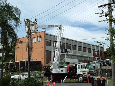

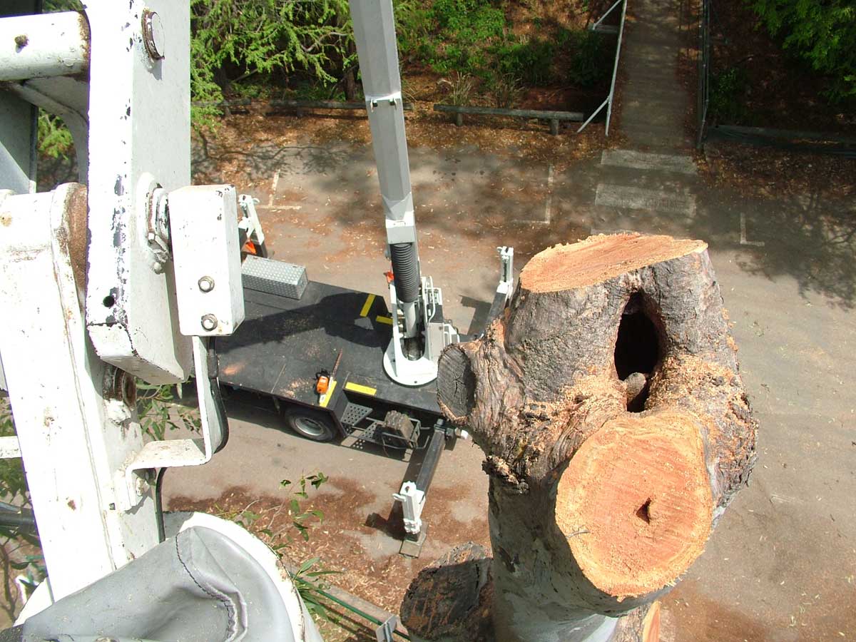

I've been up in one of those things before, shooting pics and video for a client who has a abor company (I'm not allowed to say "tree lopping" 'cos those blokes are "cowboys").
Anyway, the biggest bumps are from each section of the crane thing kicking in.
In Australia, before taking down a tree you have to check for wildlife, which they did the day before. Then there was this possum that staggered back from a very late night. Yes, his hole/home was in the void at the very top where the tree extends outwards to form its 'crown'. The missing branches didn't seem to deter him.
Due to some wildlife laws, you've got to get in a "wildlife expert" (read: expensive greenie consultant, that will be $1000 for me to pop in and visit thank you very much) to ensure that the thing isn't startled as you bring the tree down in sections. They survive thunder and lightning in the middle of the night as a matter of course, but you're not allowed to startle them.
[Photo 1 is the main body of the tree with all the branches removed, ready for bringing down. Photo 2 is of the possum asleep in his hole right at the top of pic #1.]
The regular arborist guys don't mind being nice to the wildlife. Not at all. In fact they were once downright disheartened and somewhat shattered after one time when they chainsawed through a section of tree and discovered bits of a possum they had missed earlier. Sometimes you can only do so much checking beforehand, and those voids can go quite deep.
Andrew
Shooting from 150' above ground, anyone done this?-bucket-lift-1.jpg   Shooting from 150' above ground, anyone done this?-bucket-lift-2.jpg

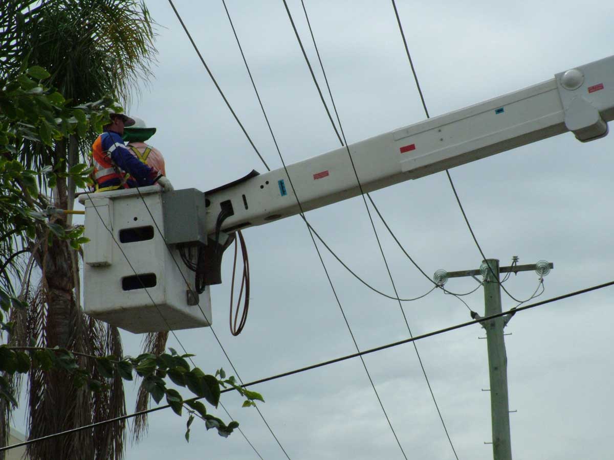

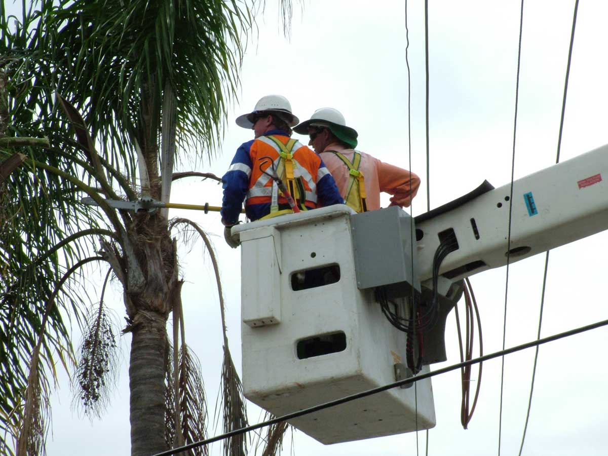

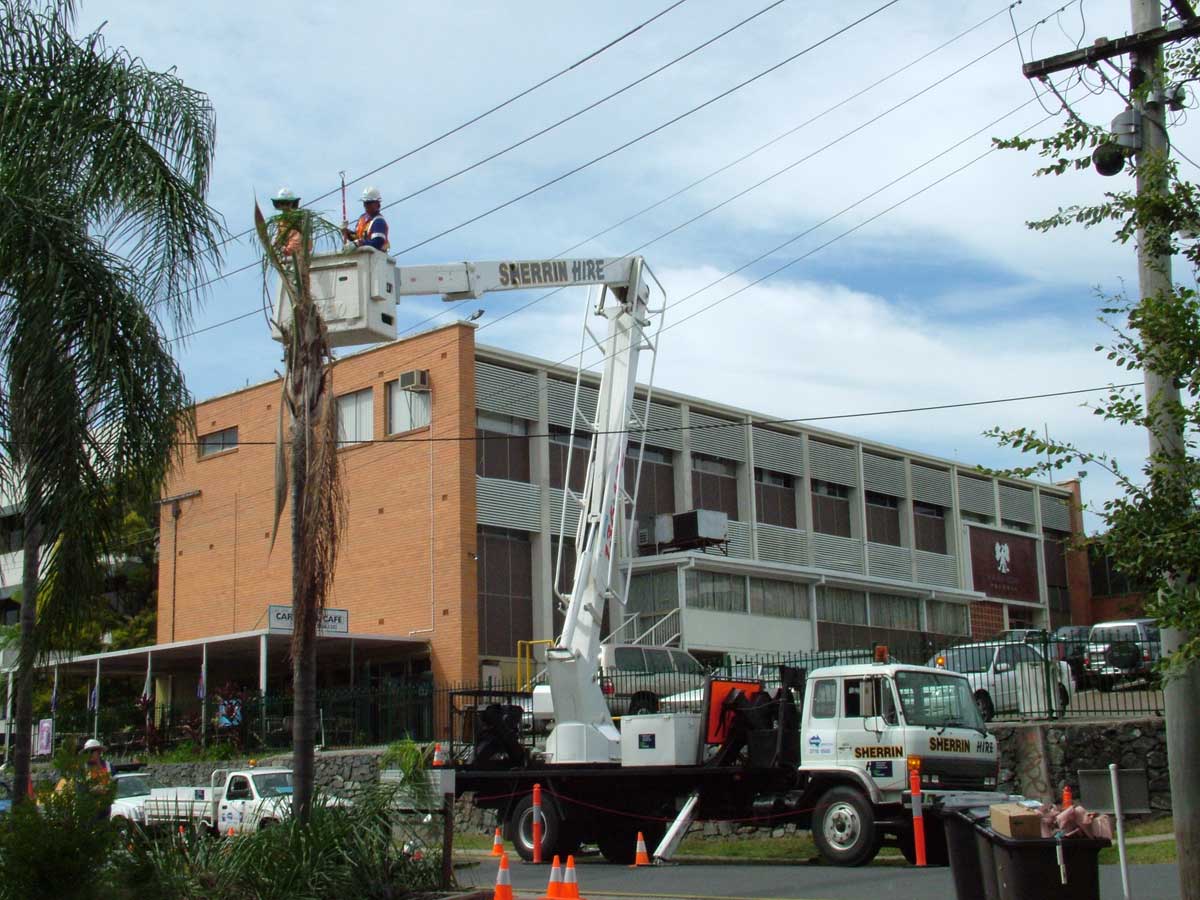

Speaking of powerlines ...
Oh, and don't do what these guys did. They poked their (very much made out of metal) arm extender thinggy THROUGH two layers of live electrical wires in order to cut down a palm tree.
A workplace health and safety consulting client of mine could not believe it when I emailed him the pics. He thought I must have photoshopped them or something.
These photos are 100% real and untouched.
Andrew
Shooting from 150' above ground, anyone done this?-powerlines-1.jpg   Shooting from 150' above ground, anyone done this?-powerlines-2.jpg
