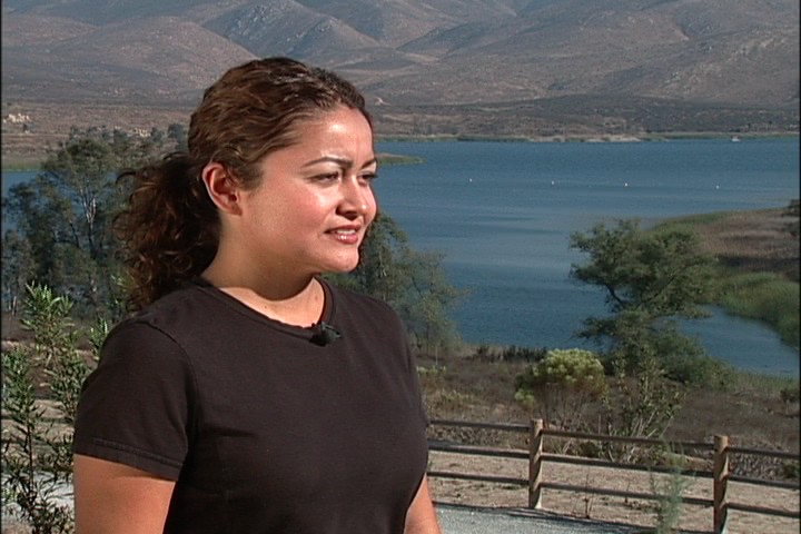

Here's a still frame from an outdoor interview I shot in San Diego this past weekend for a project we're doing in both English and Spanish
I faced the subject, Myriam S. at an angle into the late afternoon sun - then filled with a large (5') silver/gold flexfill on a stand from 3/4 behind her right side. That was enough to pop her out of the late afternoon background. Two hours earlier, I would have needed an overhead scrim, plus front fill. Two hours later the sun angle would have been very low and I would have needed to lose the lake in the background in order not to make her look like she was halloween uplit.
As it was I could have used some diffusion like a silk front of her to soften those cheek highlights, but since we had to shoot everything twice (once for the English Version and once for the Spanish Version) the time in the interview schedule just wasn't there to do more.
The point is that every setup requires you to THINK about what you have in environment and sun and shadows - what you need to make the talent look their best - and you need to have the tools necessary to change what you can.
