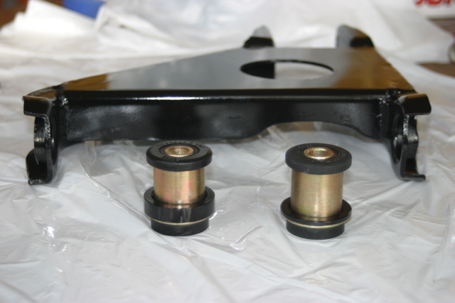

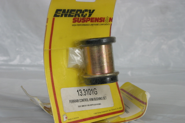

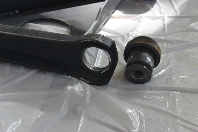

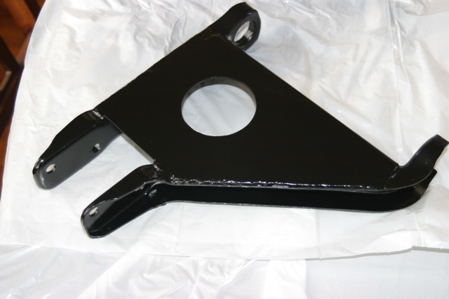

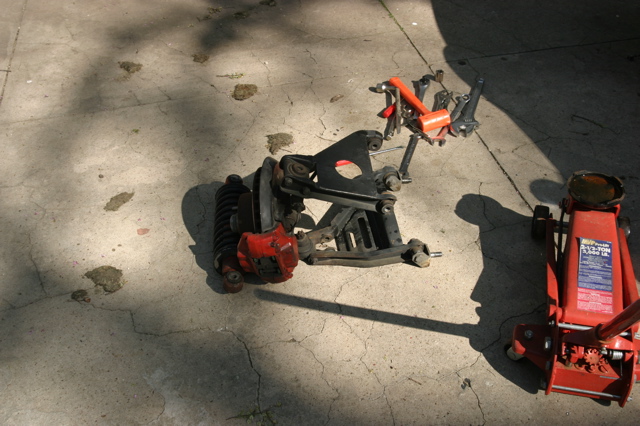

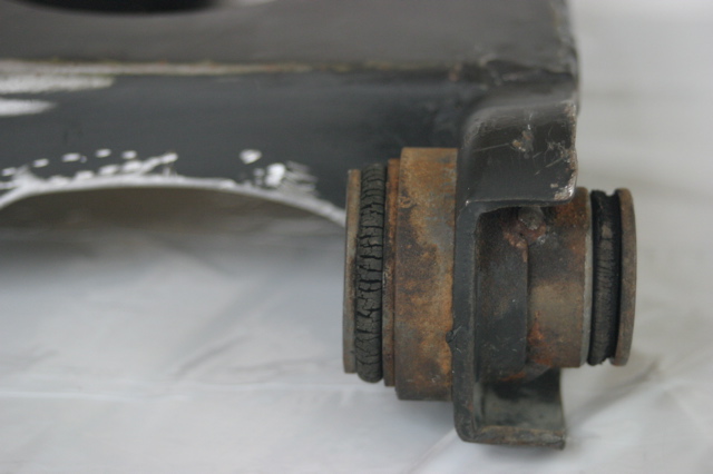

While time lapse video are cool, they would be more for fun than anything.
Most folks that purchase high end cars want some form of documentation to show the work was performed, and when. Here are a couple of examples of an A-Arm rebuild with a mod to clear racing shocks, of course I did not post every pic of the process.
