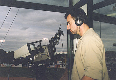

Ugly Old Thing...
Roy: So here the ugly old rig is. Unfortunately you can't see the AC/DC but thought you'd get a kick. This is from the inaugural season down by the forks.

Thanks, Shaun... truly cool stuff. You've worked a few places I've been... Bomber games, Goldeyes, etc. Also, I have a son, Sean, who did ENG/EFP for the New VR, in Barrie. He did a lot of indie shooting, as well, and directed some things, wrote a few more. Just had a meeting with an electronics engineer who used to be a battery consultant, and he says, should be no problem. Also working on an idea I had... a plug that will let me power the cam off power tool batteries - 12V to 15V. Cheaper than Anton Bauer, but then, what isn't?
