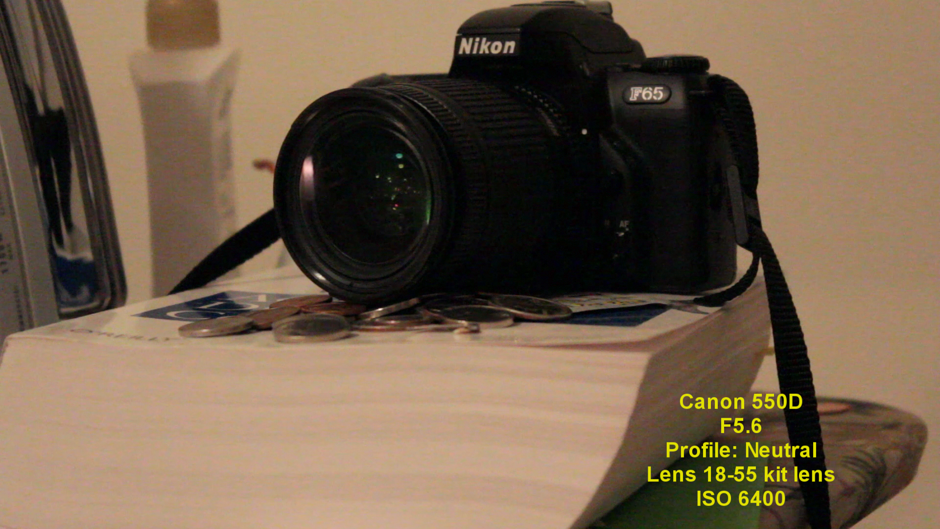

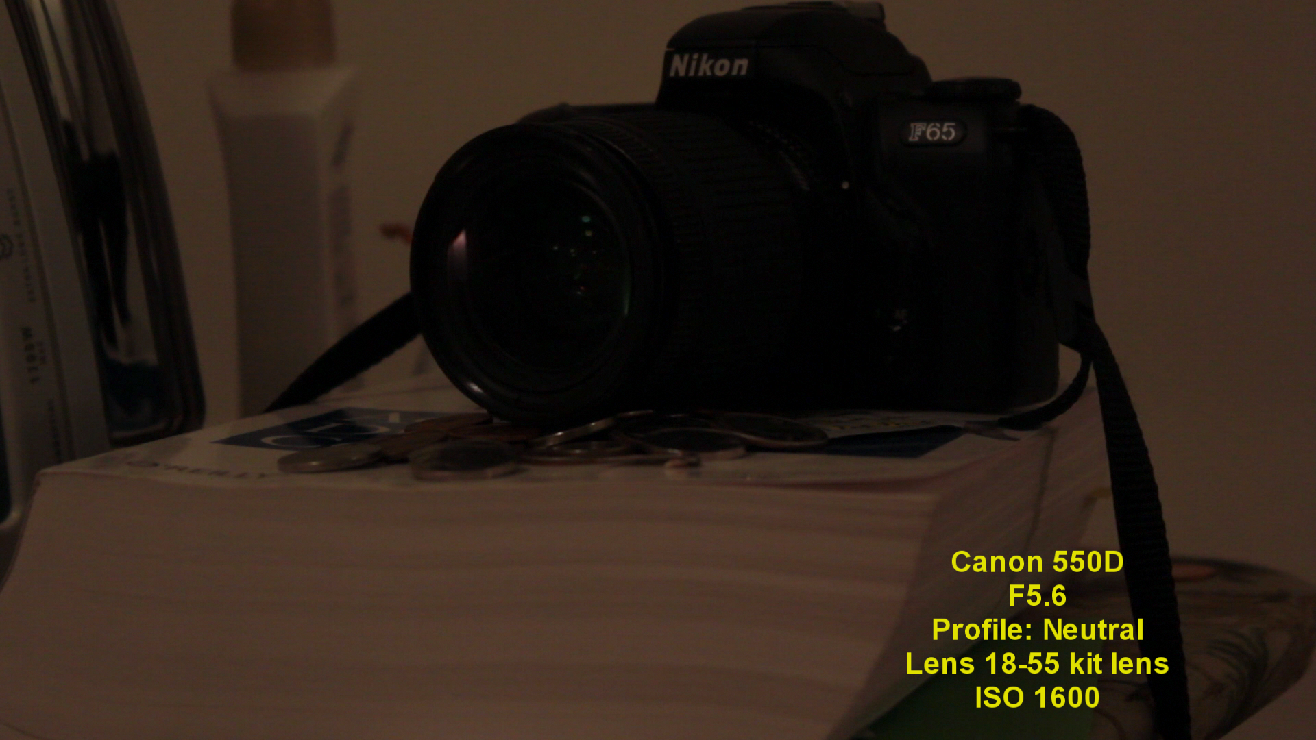

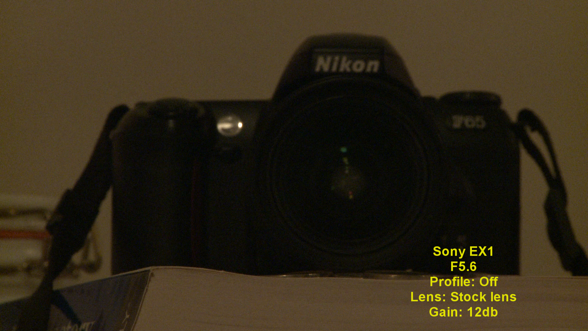

To be fair, I have the 18-55m F3.5-F5.6 zoom mounted on the T2i right now as it sits next to me. So I decided to try a little experiment. What would happen if we pit the EX1 against the T2i (with kit lens) in a low light scenario.
The setup:
Canon T2i with 18-55mm kit lens, set to record 1080/24p video. Lens set at F5.6 ISO 1600
vs
Sony EX1 set for +12db gain which puts it a similar ISO (by my measurements). Lens set to F5.6, also recording 1080/24p with the picture profile set to off so as not to color the results.
The results to me are not surprising, but they are illustrative. Both videos were placed into Sony Vegas, and a frame extract done to lossless PNG.
(For those who care, available light was 4.2FC/45Lux. My meter indicates a proper stop of just over F2.0 for correct exposure at 24p/ISO1600)

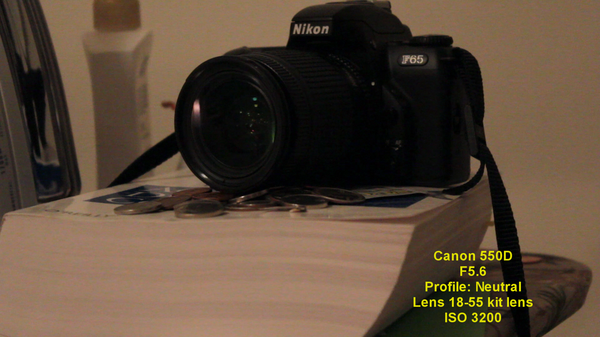

Just for fun, I recorded two more videos with the T2i. Same paramters, but ISO at 3200 and 6400. Here are the results.

Nice test and example shots Perrone, thanks. I agree with you completely. On Saturday I used my recently aquired Olympus Zuiko 50mm 1.4 on my 550D, needed a shot in low light, the EX1 would have done it, but I didnt like the ammount of gain needed. So I wacked the 1.4 onto the 550D, wow, who put the lights on, an absolute life saver.
