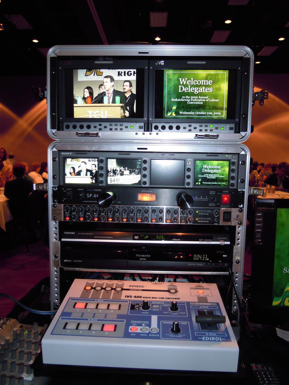

I own the Edirol LVS400 right now. T-bar is the nicest I've used outside of Ross or Grass Valley switchers. Signal is good. Cuts are fast, which can be a problem with SOME frame store sync switchers.
Edirol / Roland LVS-400 Live Production Switcher LVS-400 - B&H
I'll be replacing it next year with an HD offering yet to be determined but it is a SOLID little unit.
