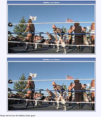

Originally Posted by Steve Kalle View Post
How can't you tell that its 800kbs? There is a HUGE difference. The 800kbs is seriously blocky. I used 2 pass VBR and Max Render Quality on both.
They 'claim' video to be an expertise and even have a production crew and a trailer capable of multi-cam live internet streaming.
Here is a screen capture from both videos, exactly the same frame. Now you tell me if there is any difference. I only see a slight difference if I go full screen, nothing at this resolution.

You can't compare the quality of video by taking a single frame from each. Just hit play and you will see all the 'blockiness' of the 800kb/s video. The sky looks like it is moving due to the artifacts.
Btw, this exact same problem of comparing single frames came up in the nanoflash forum where they were comparing 35Mb to 100, 180 & 220 Mb/s. Only when they hit play, some were able to see a 'sheen' caused by moving noise.

Do you have a way of downloading the actual footage? You probably don't...
They may have promised no transcoding, but there should be a HUGE difference between 800Kbps and 3Mbps. The fact that a difference is barely visible is a clear indication that they did in fact transcode your footage.
Do this: clear your IE cash and on this very page start downloading both videos at the same time. Watch the slider moving - they both move in sync.
Translation: both videos are the same bitrate.

I don't understand how or why you can't see a difference but everyone else can. Hit play and just watch the sky - the blue in the sky 'moves' only in the 800kb video.

I see quite a difference in quality (as Steve says, probably most noticeable in the sky, but look at the flags, or any edges in the images...), but I'd be surprised if the average YouTube watcher would care about the difference :-). (Not implying here that Steve's audience couldn't easily see the difference...).

OK, I concede.
I was probably looking for a huge difference... I thought that four times higher bitrate should yield differences you can spot from a mile away...
