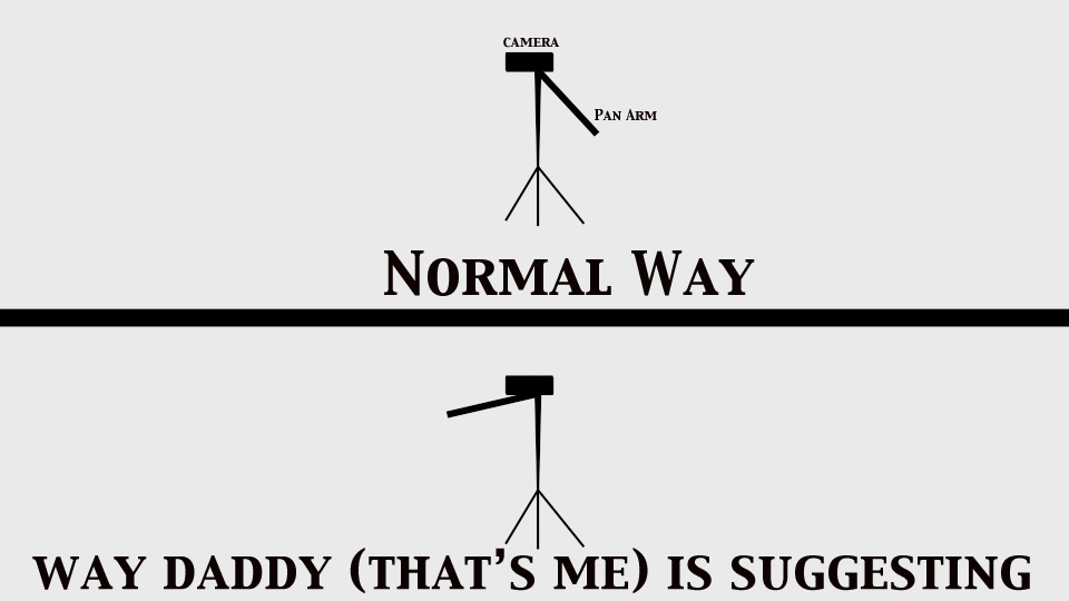

I don't know if this'll help you, it works for some folks.
I shot high school football, very briefly, for a guy who taught me a trick where you point your pan arm AWAY from you, like a gun barrel.
If you're right handed, this'll mean putting the pan arm on the left side of the tripod, operating it with your left hand to leave your right free to zoom.
It's a little weird, and it does strange things with counterbalance/weight, in my opinion, but it did seem to work okay.

This may be too difficult to describe, therefore I have included a complex and very technical illustration.
One thing it does not show is switching the pan arm to your left side if you're right handed. What I mean is, if one is standing behind the camera, usually for a right hander, your pan arm is on the right side of the tripod.
My tripod has the option to screw it onto either side, so if you use this technique, I recommend screwing it onto the left side so your right hand can zoom or focus.
