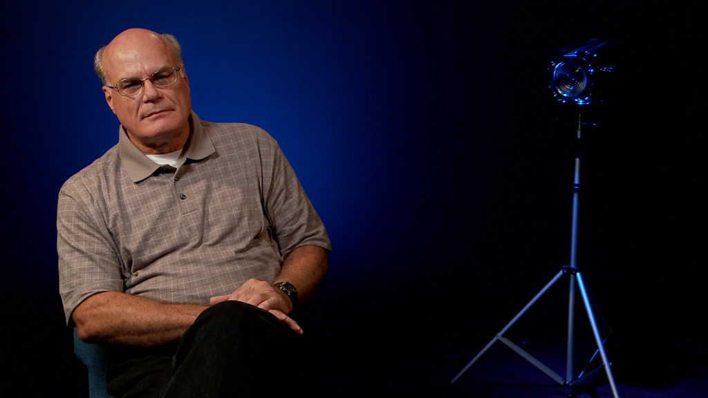

In addition to using a colored light on the black background, I use a barn on the hairlight and position the edge as high up as possible on the back of the head before creating a "ping pong ball" reflection. In this setup, the hairlight is a 250w Lowel Pro at about 50% intensity with a sheet of diffusion on a Lowel gel frame.
It's not perfect, there's some reflections from the Key (Lowel Rifa 44) and Fill (Altman Micro par).
