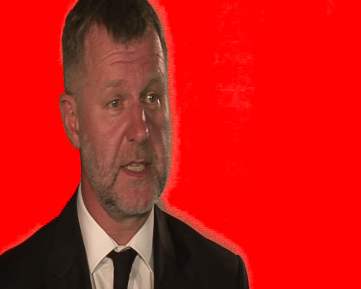

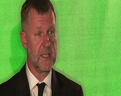

I've attached two still shots from some past footage. The first is the clean 'as shot' image. You'll see on the left of the frame the shadow of the guy's head - caused by my poor lighting of the subject (not of the backdrop).
But it keys out fine. (And it shows that the greescreen effect produced by the light-ring doesn't have to be perfect to get a great key).
What is seen in the keyed image on the right is the Halo on the righthand side of his face and shoulder. This still was exported from Premiere and had Boris Continuum's chromakey applied with no tweaking of the settings.
To get rid of the Halo you can play around with the settings of the effect - or apply a second key targeting the Halo effect.
Often I find boost the brightness and contrast in post can help.
I hope that helps.
If anyone has the definitive answer to outlawing the Halo, please share!
