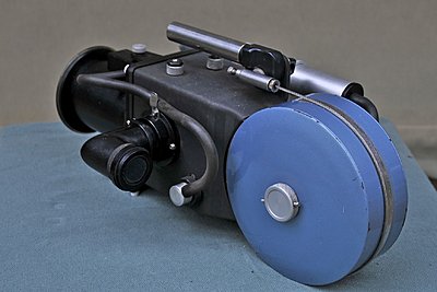

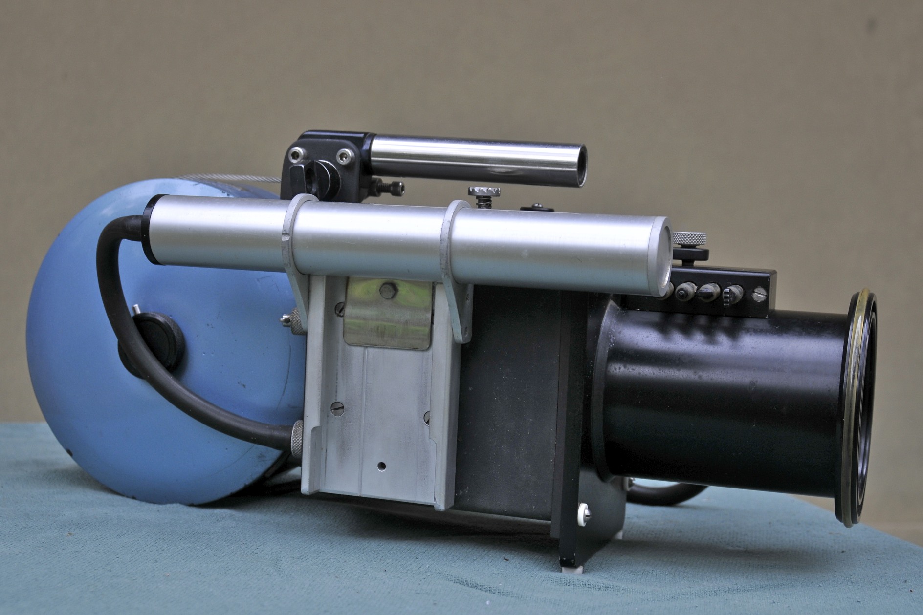

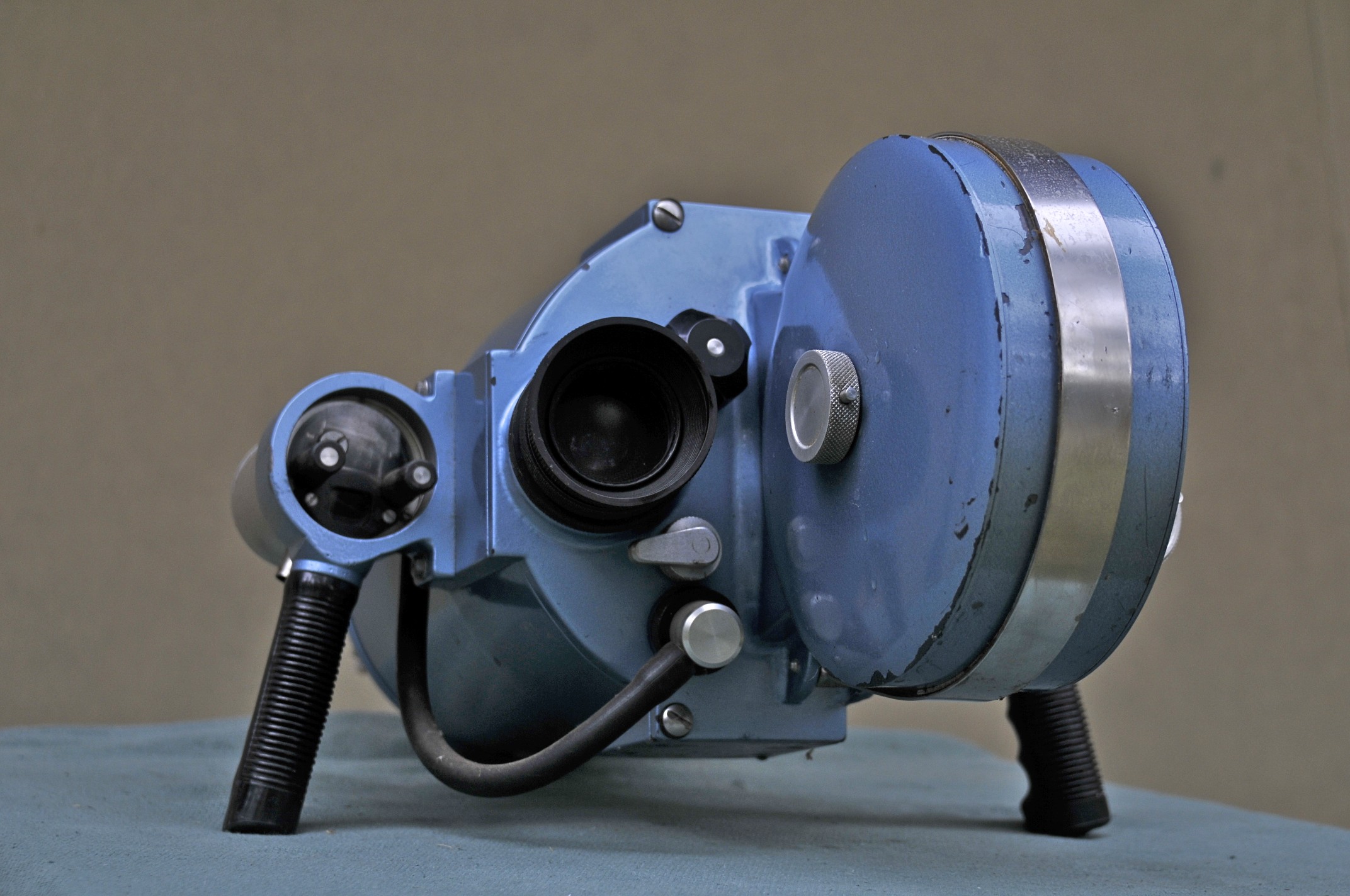

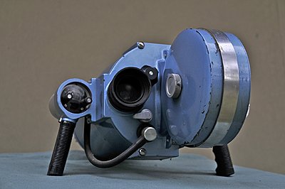

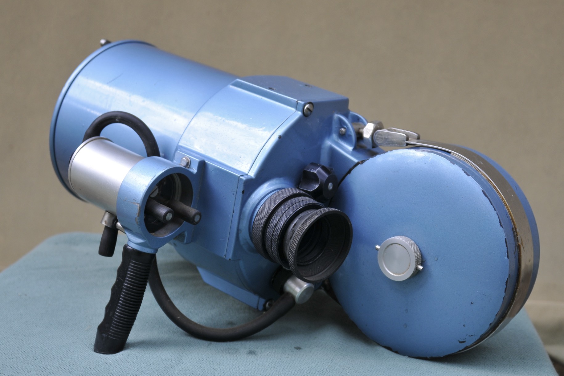

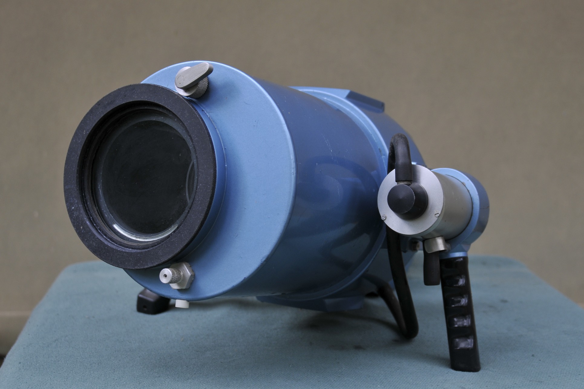

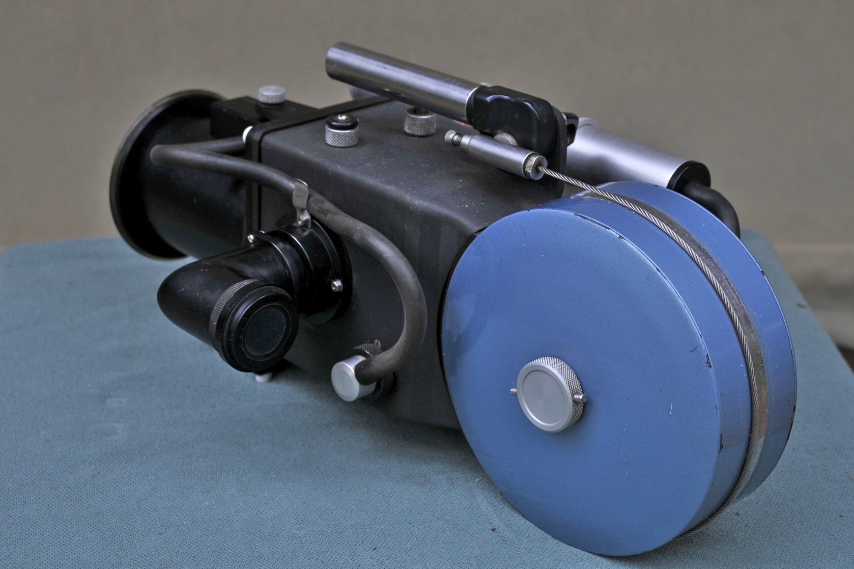

At one stage instead of housing existing cameras I made two waterproof 16 mm cameras. My starting point was to remove the movements from Arriflex S cameras and build these into waterproof enclosures. A major benefit was weight reduction, at that time a housed 400’ load 16 mm camera weighed about 95 pounds whereas my larger unit weighed 37 lbs and the smaller about 20 lbs.
Obviously no one would be interested in using them nowadays but I am having trouble bringing myself to scrap them. I was wondering if any one has a better use for such items?
A few specifications: -
Both used 400’ load magazines, both had basic control boxes on a flexible lead that could be used on either the body itself or a tripod.
Both had reworked viewfinders so that they could be used with a diving mask.
The larger one had a turret of three lenses so that I could select from a 12-120 zoom, a 55 mm Micro nikkor or a 55 mm Micro nikkor with a 2X televerter. I could also add or remove a close-up lens on the zoom.
The smaller one had a 6X zoom only. I could remove the front part of the housing for out of water use. In the rebuilding process I scrapped the Arri mount and replaced it with Nikon and made an adapter that converted Nikon to Arri. That is I could use any Nikon or any Arri Std lens.
For those who have forgotten 400’ of 16 mm film ran for ~ 12 minutes at normal speed, a single light work print cost ~ $0:50 per second, was not re-usable, had to be handled in a light proof changing bag and depending on the location it could be several weeks before viewing the results.

Antique 16 mm waterproof cameras – home wanted.-_dsc8639.jpg   Antique 16 mm waterproof cameras – home wanted.-_dsc8641.jpg
Antique 16 mm waterproof cameras – home wanted.-_dsc8647.jpg   Antique 16 mm waterproof cameras – home wanted.-_dsc8659.jpg
