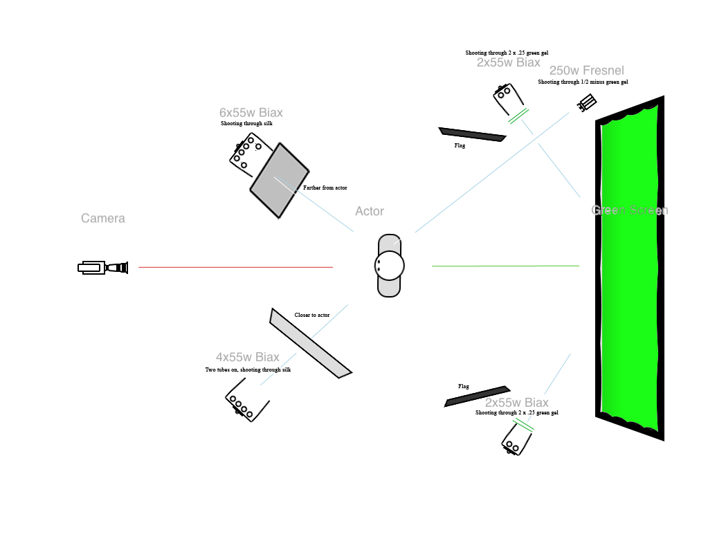

Here is the basic setup I have been using for a temp green screen area while I rehab my main shooting area. Been shooting mainly waist ups .
