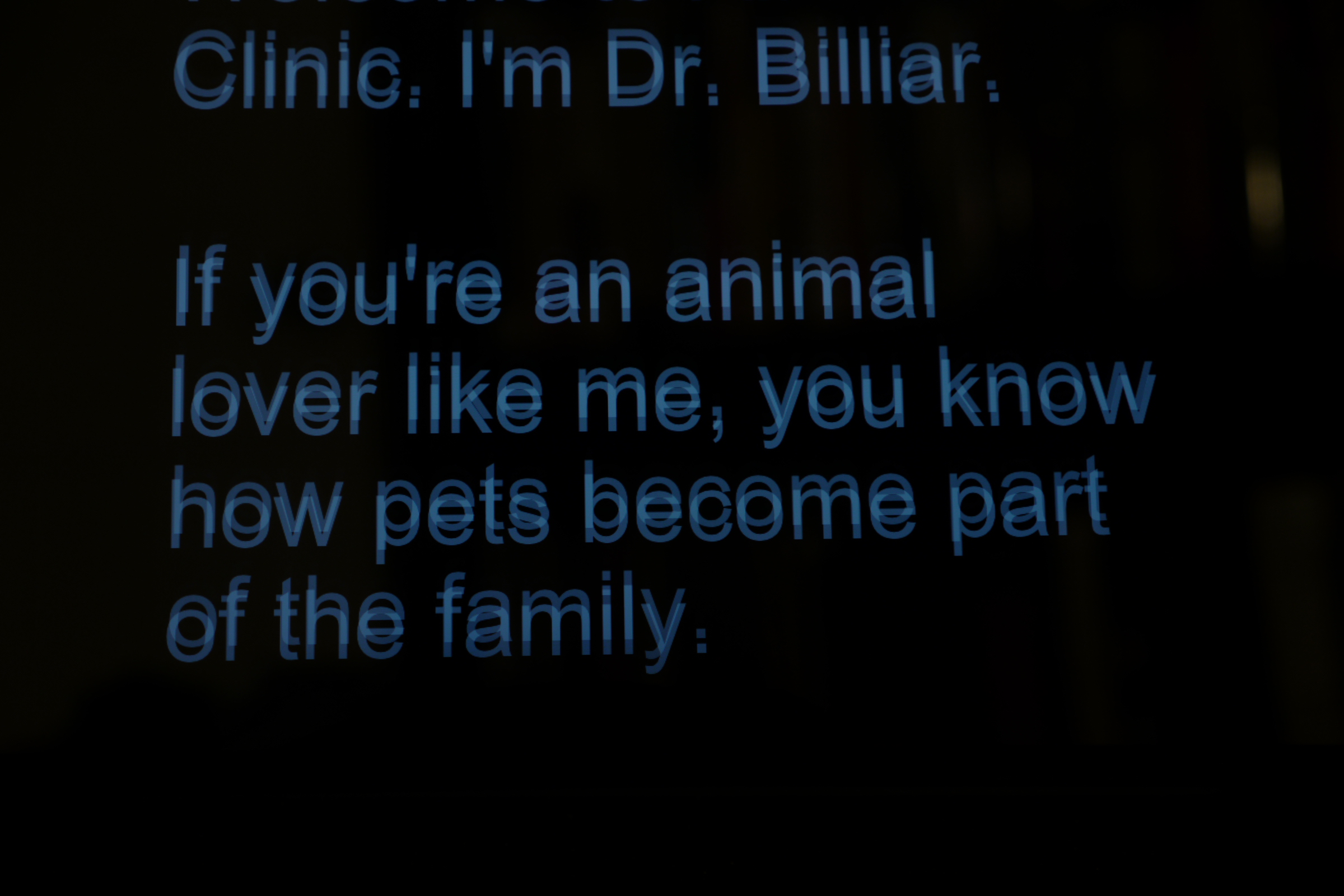

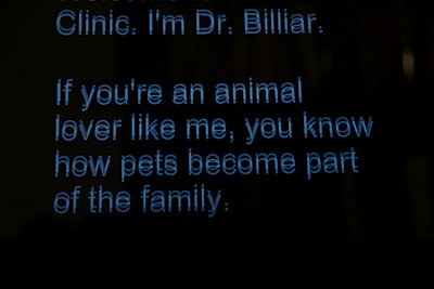

Anyone else have one of these, or might know something about these things? Everything it reflects is doubled and offset, making it incredibly difficult to view/read. It has nothing to do with my iPad or Teleprompt+ app, as I can put a piece of paper with text on it and the reflection shows the same problem. I haven't been able to find any answers online. I cleaned the glass, I unscrewed the frame holding the glass and flipped the glass around hoping it was maybe installed backwards. Nothing I've done has fixed it. I emailed the company two days ago and didn't get a response. I just emailed them again.

I just got an overnight shipment in the mail from DHL. The company sent a new sheet of glass and threw in a light stand adapter for free along with a small apology note. Odd that they never replied to my emails. In any event, the new glass works!

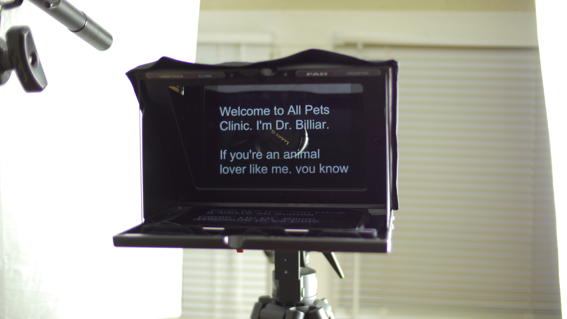

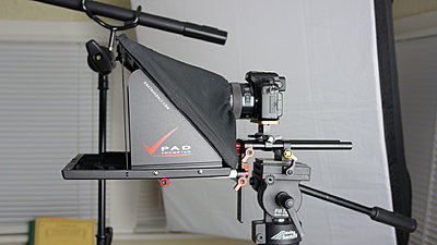

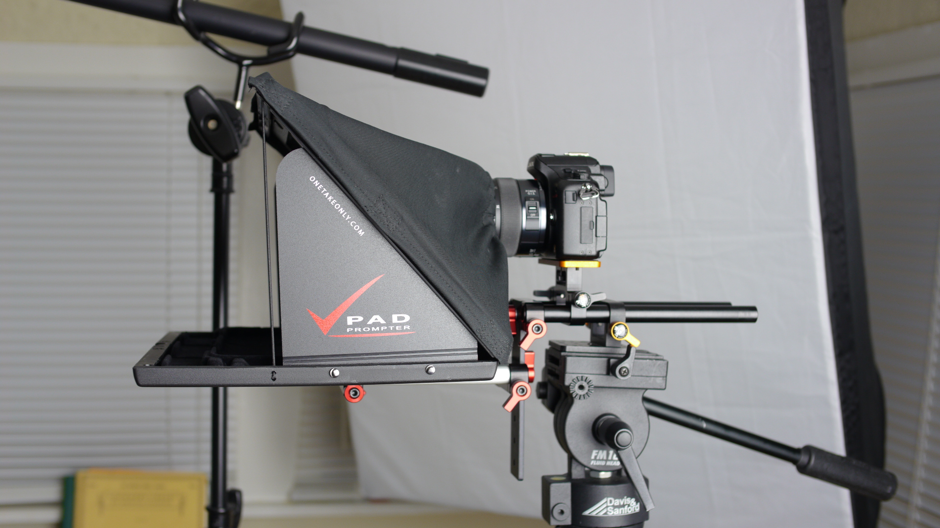

Re: OneTakeOnly Pad Prompter *Problem*
Here ya go. I'm using the Teleprompt+ app, which is great. You can control the speed of the text with the accompanying app for the iPhone.
OneTakeOnly Pad Prompter *Problem*-p1030141.jpg   OneTakeOnly Pad Prompter *Problem*-p1030142.jpg

Hi Patrick,
I'm glad that your Pad Prompter is now working as it should. It was the first time that we had a defective beamsplitter. I'm a bit surprised that you said that our price is a bit high. I started building the Pad Prompter after seeing units selling for $2000.00. I worked very hard to keep it as affordable as possible. Only the aluminum hardware included with the Pad Prompter will cost you more than the price of the complete Pad Prompter, if you had to buy from a brand name. Our margin of profit is so thin that we cant even have distributor. And when something wrong happen.....broken glass during shipping, part forgetten,etc. ....we're losing money. I spended more than $60 only for the shipping of your beamsplitter, so that you can have it next day. I prefer not figuring all the time and energy I put into this, if I would .....I could decide to go working at McDonalds and make more money ,
