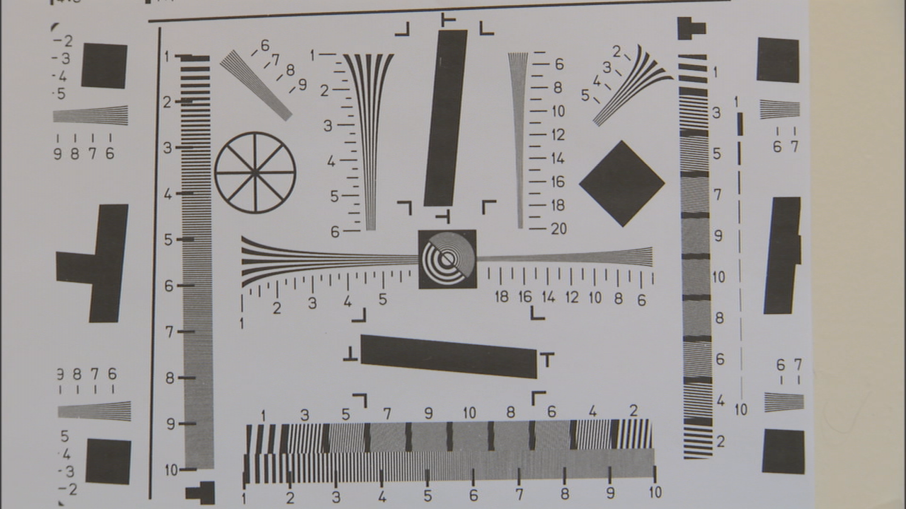

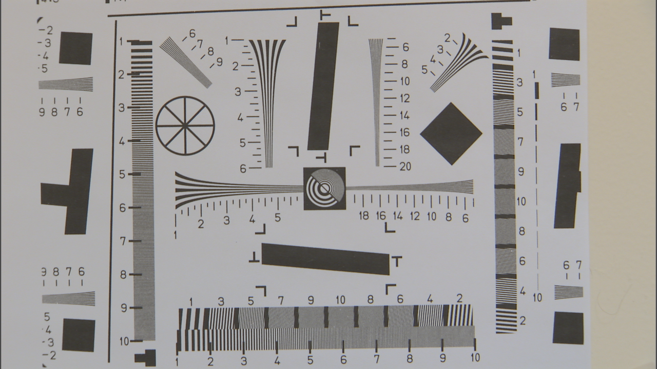

I just purchased a used Canon J11ex4.5 to replace my older J9 version. I think the J11 and J22 last generation eIXFS SD models are some of the best deals on the used market, and can be had as a pair for less than the cost of a "standard" telephoto HD lens without extender. There should be many people who would like to know how these models stack up against a premium HD lens.
Below are a couple of still frame grabs from testing I was doing with my old HDC27H Varicam. The first frame is a resolution chart recorded at 8 bit uncompressed 1280x720. The second frame is the same chart as recorded by the onboard DVCPRO HD tape deck, and played out via HD-SDI jack. A very noticeable difference. Lens for those tests was the J22ex. I am very interested to see how much of a difference the HD glass makes on the same chart.
How do I test HD/SD lens performance?-reschartuncompressed.bmp   How do I test HD/SD lens performance?-reschartdvcprohd.bmp
