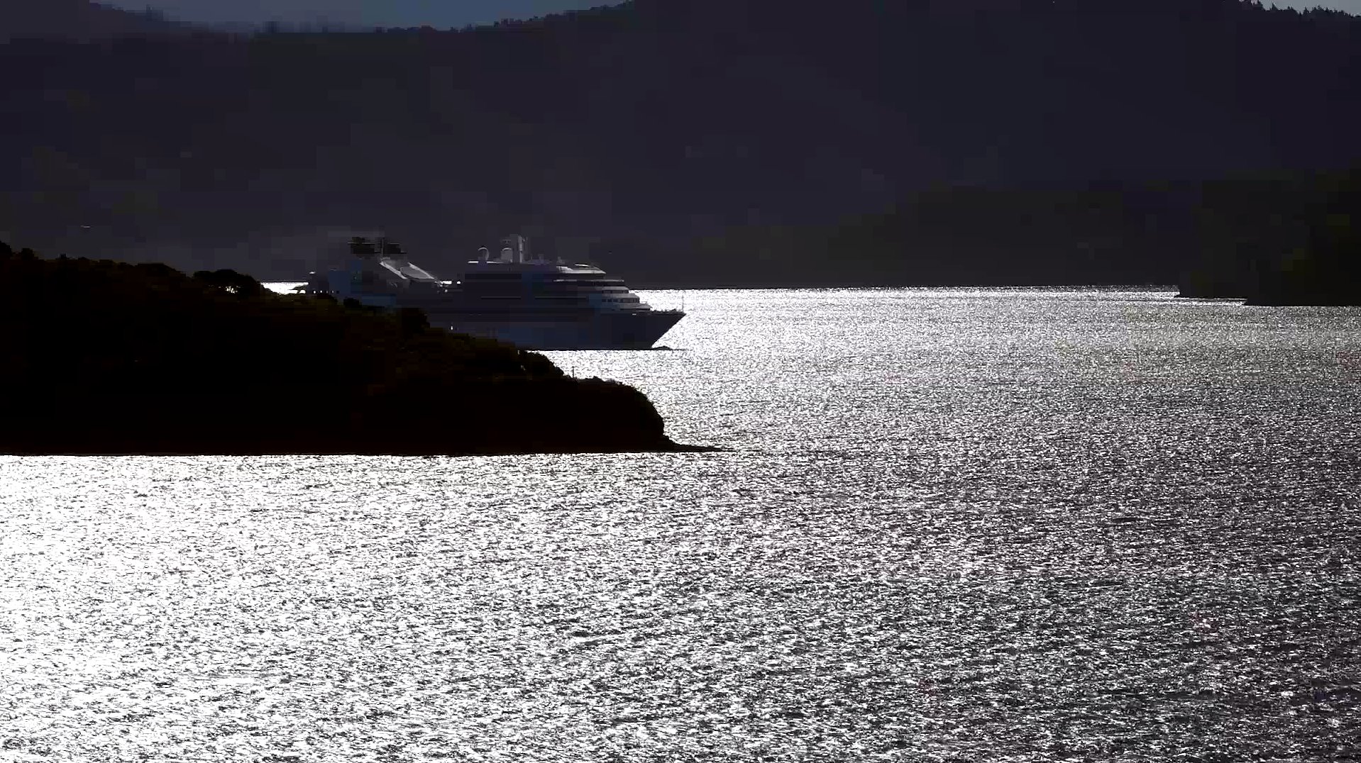

I have been shooting with the DSC-RX10 for some time now and I thought it might be useful to share my experiences to date. I do have a problem but it is not in high motion areas, quite the opposite in fact. I run into problems with harshly lit scenes where poorly lit hills covered with native bush, dark dull green, exhibits what I believe is macro-blocking. I have uploaded a screen cap jpg, contrast enhanced for viewing purposes, as an example. Note the problem on and particularly above and behind the cruise ship.
I shoot at 60p and the macro-blocking is not visible in the MTS file. I place the MTS file on the timeline in Vegas Pro 12, do minimal manipulation, and render off. When I render off to an AVCHD 60p template the problem occurs. If I render off to a 30p template the problem is not visible.

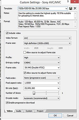

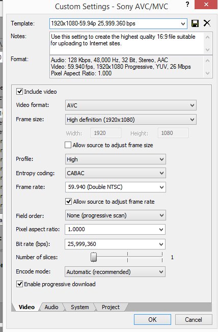

Thanks Ron, most helpful. I had selected various templates both MainConcept and Sony with various bit rates. Now I went back and selected the Sony template, jpg attached, max bit rate 25, 999,360 as you see and sure enough no macro-blocking however I now have a different problem and that is, and I shall call it micro-jerkyness. It is subtle but the passengers on that cruise ship would be losing their teeth and the ice in their cocktails would be doing a lot of chinking. The 29.97 render does not exhibit this.
Perhaps a computer problem. I have an HP Envy i7 2.40 GHz 8 Gig RAM

Looks like you started from the internet preset rather than the AVCHD preset. The AVCHD preset does not allow source to adjust frame size or frame rate or enable progressive download. Just re-encodes to AVCHD. Just highlight the 16 in bit rate and put in 28. You will then get a m2ts file.Starting with the internet preset will get a mp4 file.

Nope, I enter 28,000,000 but when I move the cursor to another location the number reverts to 25,999,360. Yes, the rendered file is an m2ts file but the total bit rate is only 15,515 and VLC won't play it. Windows Media player plays it OK but I prefer the xdcam 35mbps 29.97p render played in VLC player.

You are correct as I have just tried too. Must be setting the average bit rate rather than the max as the Bluray preset which is 60i sets the value at 21999616 which I think is the average for the 24Mbps 60i. Maybe the encoder is CBR !!! Anyway the fig you posted above is for the internet preset.
Checked in Edius my normal editor and the same thing happens !!! Though Edius does allow CBR or VBR settings to choose rates. Yet if I export to Bluray preset 60i it lets me encode to max much higher than 28Mbps !!
