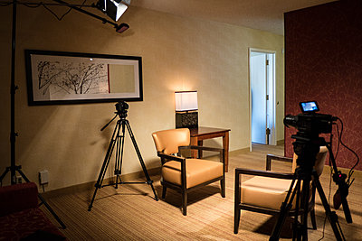

Re: 3 person interview
My last 2-person interview was in a tight hotel room and with little time for setup. I resorted to using two fluorescent case lights as the key for each subject, and two battery powered LED lights as hair lights. If you can spend the extra $200 for portable LED lights, you'll be pleasantly surprised how often they come in handy.
3 person interview-icon-interview-setup.jpg   3 person interview-lighting-setup-1.jpg
