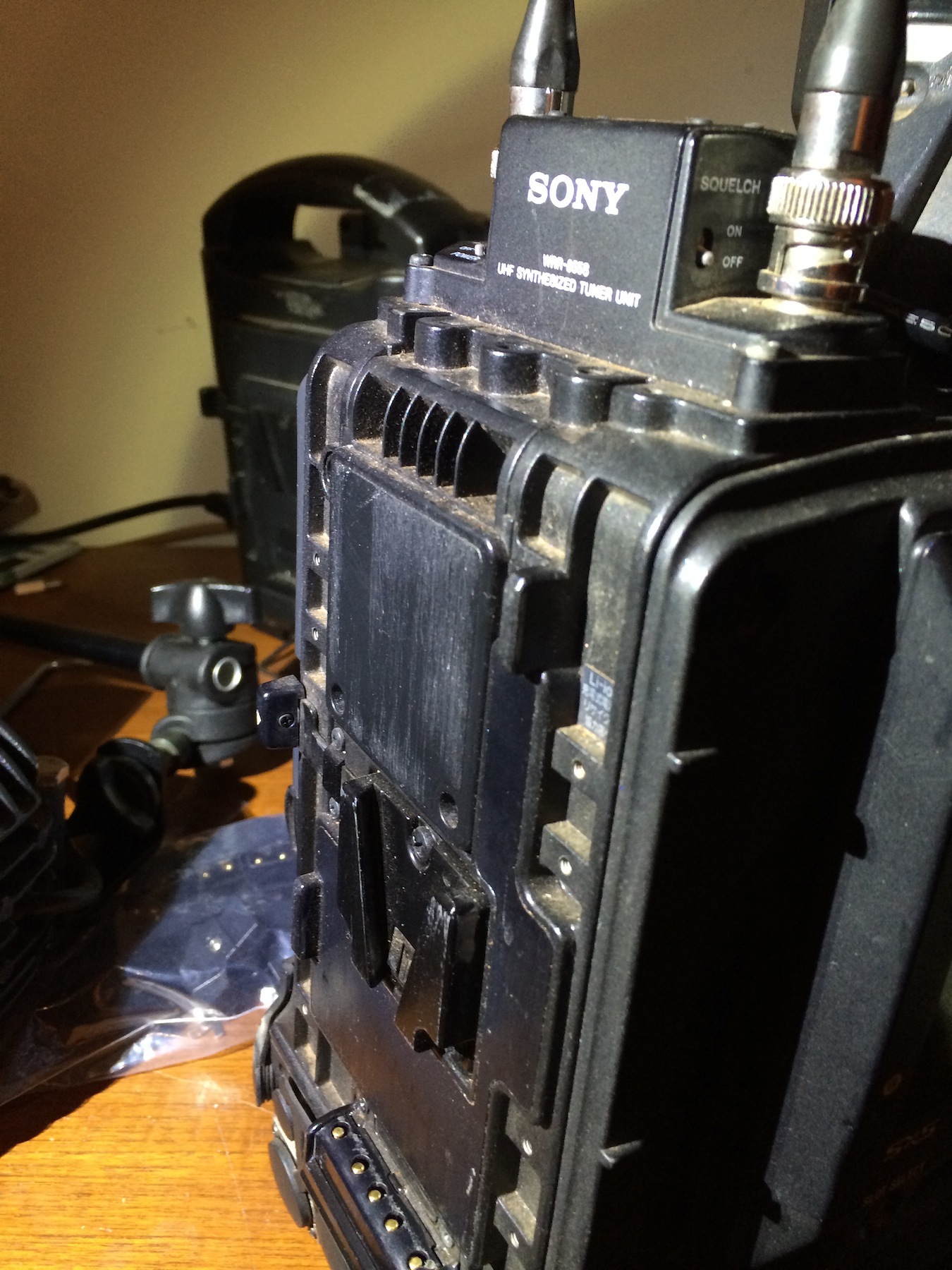

So with bated breath I opened my parcel today, charged them both and went to put them on the camera.
They work, but they don't lock in place, neither of them. One I would see as a unit fault, two of them sounds more like a design fault. Now, I don't believe the latter as I have heard quite a few people around the traps say they use these so what am I doing wrong? Aren't all v-locks standard v-locks that lock? Is there something in the bleeding obvious realm I don't know about v-locks after all these years?
Currently they are unusable as although they power the camera sitting still, once you start moving around you lose connection quite quickly. It appears to me they don't slide down far enough to click the lock no matter what I do, any ideas?

Found that the issue was a lug that seemed to serve no purpose whatsoever apart from preventing Sony cameras from using Dynacore batteries. So I found a hack. Excuse the dusty camera, just came back from another desert shoot.
When a v-lock doesn't lock-2.jpg   When a v-lock doesn't lock-sequence-1-01263314.jpg
