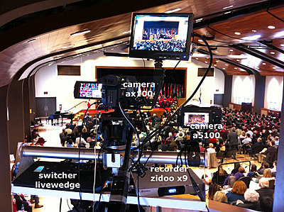

the little x9 in the picture records the output from the switcher as either mp4 or ts and does a decent job in good light but I cannot adjust the bitrate but can control the resolution - thus the question

The term workflow as I understand it refers to the post production process whereas In my case production switching is the preferred method as Live Streaming is the primary medium of delivery so any camera cuts, chroma key, titling and pip needs to be done insitu.and the bitrate referred to in this instance is broadcast bitrate: H.264 High, Main, Baseline Profile ( max.720/30p 10Mbps ), AAC-LC ( max.256kbps ) and multi bitrates must also be transmitted from the rtmp server in 240p , 320p,480p to allow lower bandwith viewers unbuffered video
I cut my teeth in Live TV back in the late 60's and it's still a thrill to see a polished production sent out to a live audience. Back then it took a semi trailer full of heavy gear, and a crew of 7. - Today I accomplish the same (if not more complicated productions) one man band with a few devices stuck on a tripod so when you say "good enough" I try to understand where you are coming from and I trust it is not in a mocking tone.
As to the zidoo x9 the android / linux tv box which records the switcher's output via an hdmi port.. Well it is a marvelous little device that cost me less than a hundred bucks, records to a usb3 stick or sdcard and so long as the result is not expected to be "cinema", then the recordings are certtainly acceptable unless the viewer is pixel peeping at 200%. Squeezing evey last drop of goodness out of it as well as all the other budget gear I use is an ongoing and pleasureable chore. thus my initial question

the x9 in it's Hdmi-In mode is recording h264 either as an mp4 or .ts
It will view / play h265 . alogn with I bunch of stuff I haven't even looked at. Only the hdmi-in part interests
It's variable framerate gives editing software an earache but I think that is one of the reasons it can produce such nice video at very low bitrates. both variable bitrate and variable framerate is quite an efficient process but probably wholey unsuited to much editing other than trim Certainly no grading or fancy stuff. That's why it's so important to get it right during production
