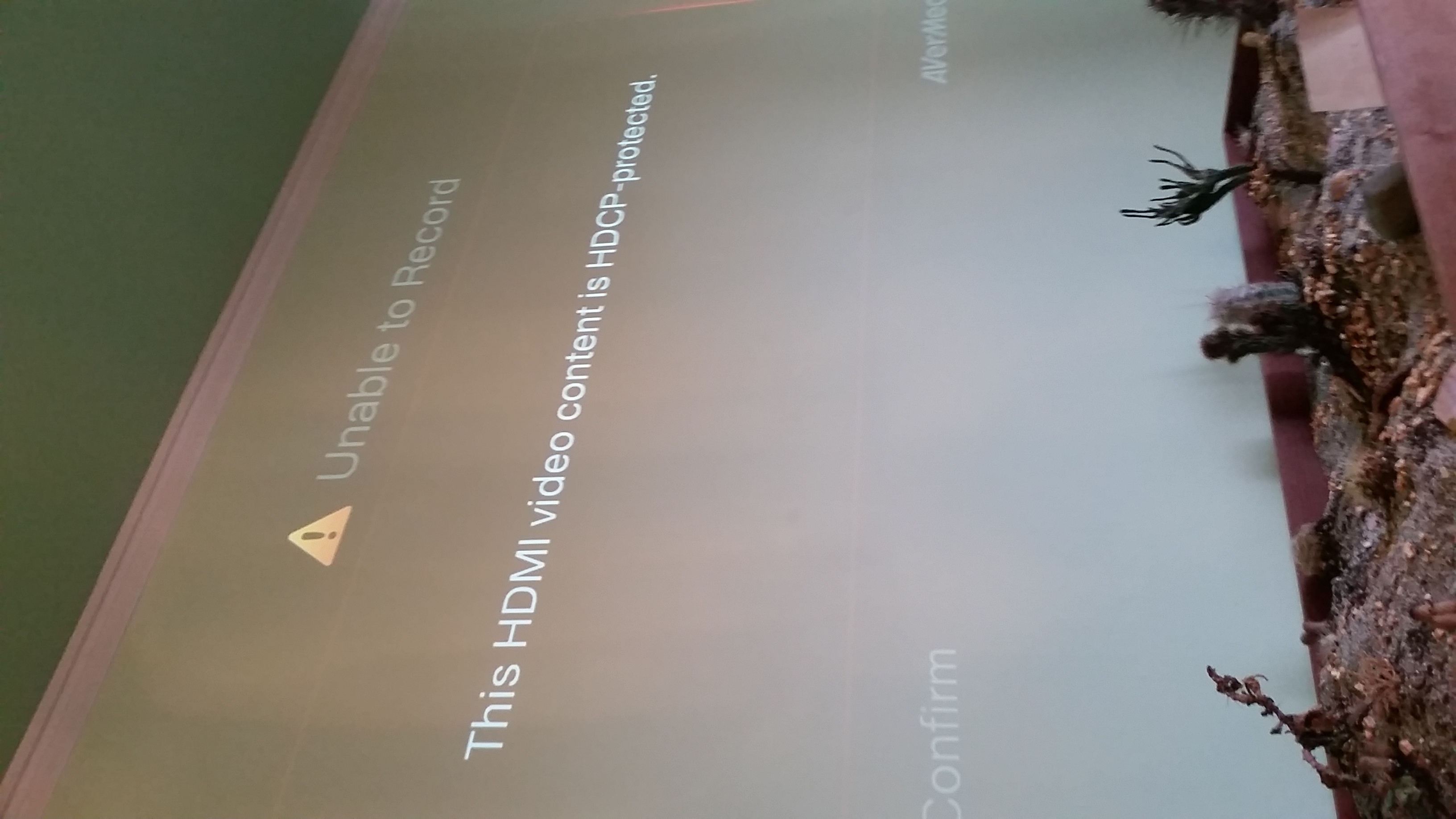

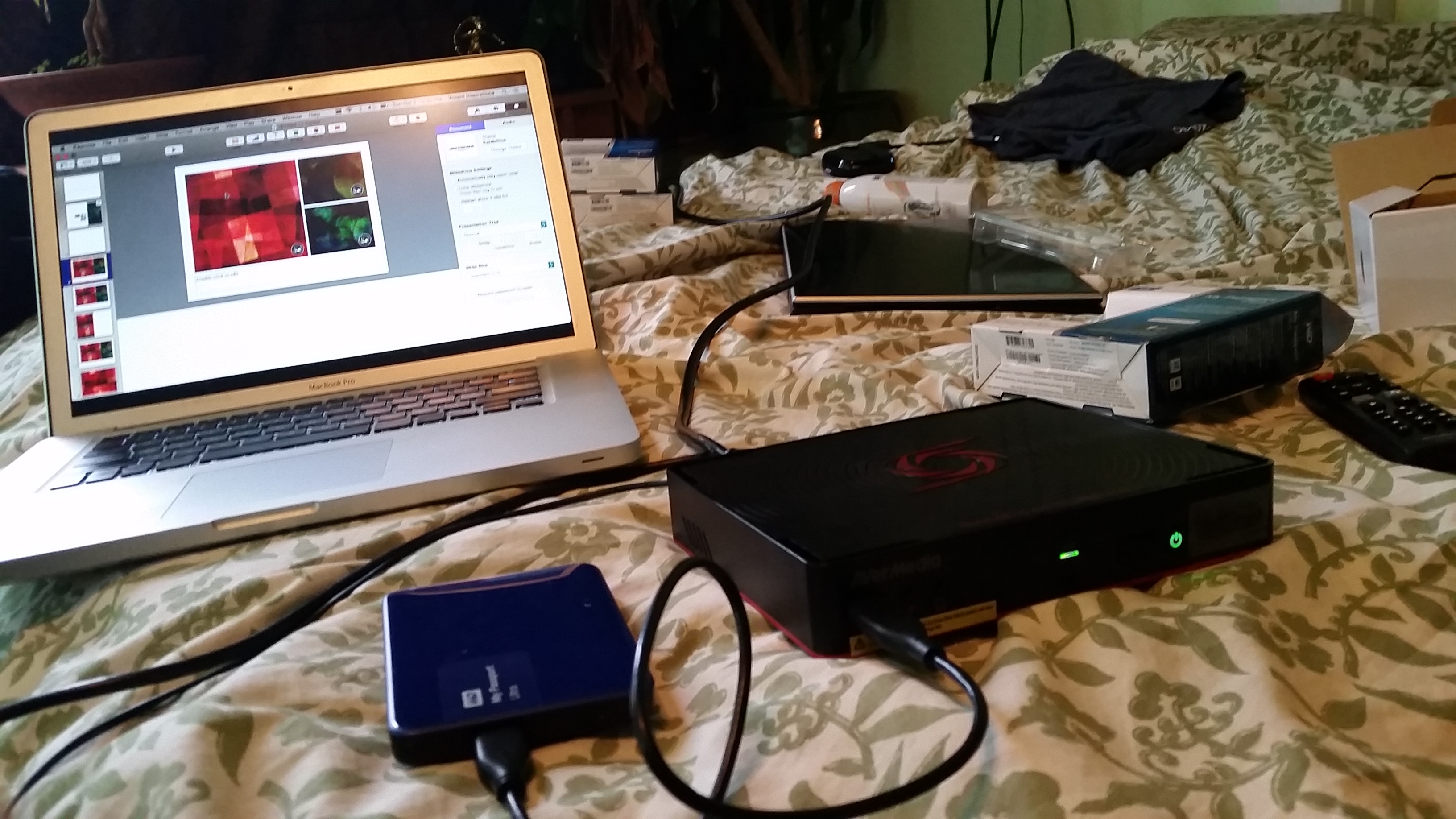

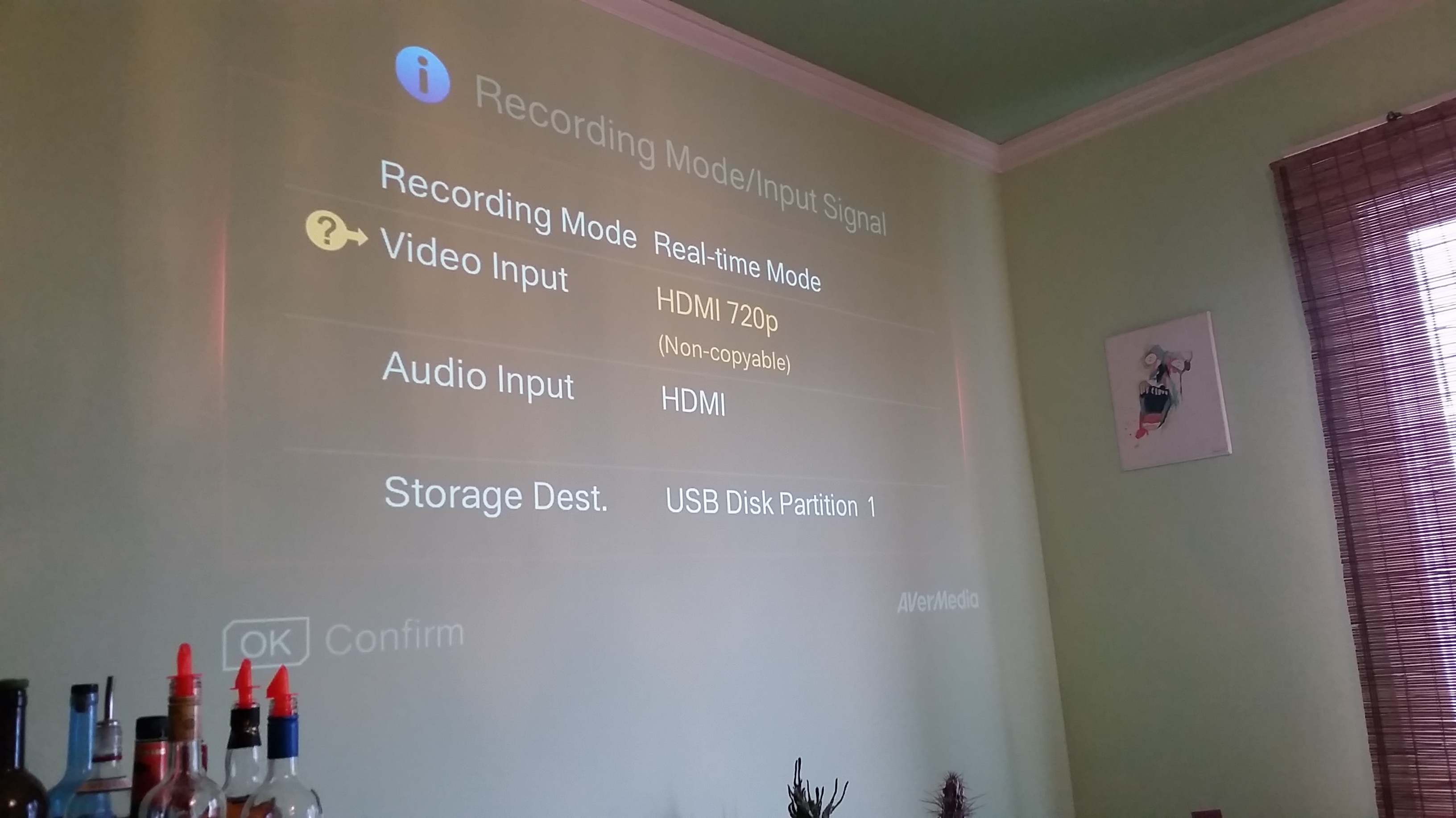

In the same vein of recording computer screen output (also to capture slides from a presenter) I purchased a gaming capture device (a few different kinds to test actually) to capture the content. There were several walls to run into before getting it setup (i can list those if anybody is interested otherwise I might make a short video) but now I ran into a big one I prob can't crack.
HDCP. It's there to stop us from copying movies and iTunes content apparently but it means nothing else can be "copied" either. Like a Keynote presentation. So my Avermedia HD II Game Capture device is all setup (and that took a bit including speciality formatting drives), but when I plugged in my Macbook Pro AVerMedia box tells me the content is not copyable. Nothing. Can I seriously not capture mine or somebody else's presentation to a gaming box?

First, the capture device *must* support HDCP. If it doesn't, there's just no way, you'd have to get a capture recorder that does support HDCP.
Once the HDCP handshake has taken place, the Mac should be able to distinguish protected from non-protected content. If it isn't, I can't think of much besides making sure that it's fully updated, and, so is Keynote or Powerpoint or whatever.
Do make sure that your HDMI cable is recent, HDCP certified(?)

Everything I've been able to find says it's an Apple issue. Everything else is brand new and updated. Xbox and PS4 and things like that are HDCP protected as well but have put in modes to allow passthrough for gaming (because gamers were cracking it anyway). However there is a hackaround, but it's seems bizarre to need one to capture something like Keynote. You get certain HDMI splitters like this
https://www.amazon.com/gp/product/B0...?ie=UTF8&psc=1
and when it hits the device HDCP has been disabled. Ugh.
