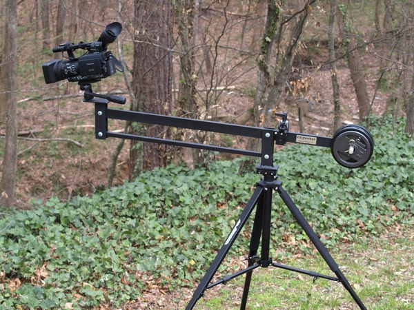

I would use a jib and lock it off. Carry a small web bag with you to fill with rocks on site to use as counter weights. http://glideshot.com/product-category/jibs/ Six miles hike round trip isn't bad if you trim down all your gear to the essentials. You might be able to find a volunteer to help carry some of your gear. Also pull up topographical and google earth maps of the site. Many times there are shortcuts from nearby roads.

There are under $200 carbon fiber cranes on EBay, sold under various brands, mine is a "Came" brand, works, folds to 30", weighs 4lb and extends 6ft. Use counterweights as suggested above, still need a good tripod or stand. I've adapted a bike stand, more solid and stable than most tripods and because bicyclists are misers under $50, stick "video crane" in front of "stand" expect to pay 4-5 times as much - I digress - stand packs down to 30", but needs a flat base and too heavy to backpack far - have carried the arrangement 10km by bicycle.

The jib idea sounds the best to me. Something that you can put in the water if need be. Was going to recommend getting a bunch of 1.5 inch PVC pipe, couplings, tee and elbow fittings and take a hack saw with you to build a frame you could put in the water. With a GoPro, you'd need to be how high above the surface?? 2-3 feet maybe? So, the legs would need to be at least 5 feet for a 2 foot deep stream, then a cross member that is wide enough to keep out of the shot. This starts to add up to 30 feet or more of pipe. So yeah, that jib idea is looking like the winner.
