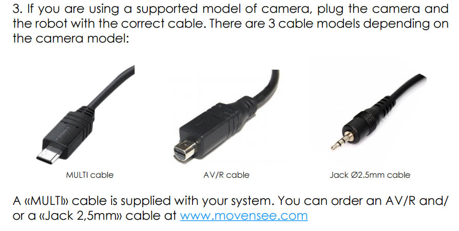

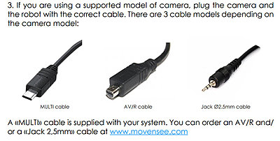

I did some research and the robotic unit is using the LANC remote protocol, which is why it only works with Sony and Canon cameras - Panasonic has their own control protocol.
Here is a link to Sony and Canon models recommended by Move n See - PIXIO Customer Care Center - Move 'N See
Most of the new Sony cameras use a proprietary multi-plug, and that is included with the Move N See. LANC originally used the 2.5mm jack, and later Sony used the AV/R plug, but newest models typically have the Multi connector. According to Movensee.com, all Canon cameras use the 2.5mm jack. Whichever camera you decide on, find out what connector it has in case you need to order an adapter, so it doesn't delay using the new device.
