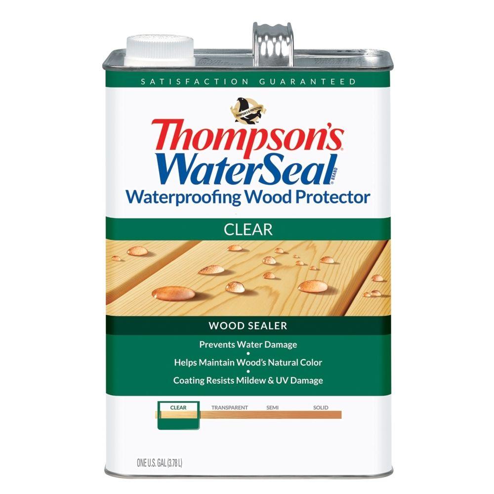

Meanwhile, do you have this stuff in Australia? Or similar. That would be my suggestion.
Shiny!
to varnish or not to varnish-clear-thompson-s-waterseal-wood-sealers-th-041801-16-64_1000.jpg

We don't have that brand but similar, I was just concerned about making the surface slippery but I'm sure there is a matt sealer I can get

Actually, whilst we think of a gloss surface as being smoother and more prone to being slippery, the appearance of the coating is more to do with the internal reflectivity which can be reduced by the addition of a 'matting agent' such as silica particles.
The 'slipperyness' of a surface is due to the macro and/or micro (a little foggy on this as it has been a while) texture of the surface coating and is lab measured to be a certain value of a "static coefficient of slip resistance'. A change in the internal reflectivity via mixing in a matting agent will not affect this.
It's always possible that a matt finish version of a product could be a completely different chemistry and therefore technically a different product, but I doubt it. Your mileage may vary, etc.

Paul - this is another option.
It depends on how much work you want to put into it. Tompson's is definitely quick and I use it on my porch deck with a pump sprayer. The deck is 2-inch thick cedar planks and it will cause the water to bead like shown in the picture on the can so that's good. For the little boxes, though, brushing it on with a "chip brush" would be easy. economical, and less messy than spraying. It doesn't give a hard surface like varnish, though.
