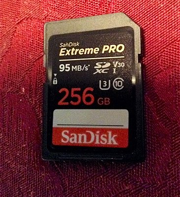

To go with it, I purchased 2 x SD cards (SanDisk Extreme Pro SDXC UHS-I Card, 256GB, Speed up to 95 MB/s 633X - have taken a screenshot, see attached). When put in the camera, I was prompted to format them which I did.

Just wondering, is the SD card a U1 or U3?
Reason for asking, if it is U1 the maximum it will record 4K at is 60Mbps.

The SD card is a U3. I have attached a photo of the card If this helps at all.
