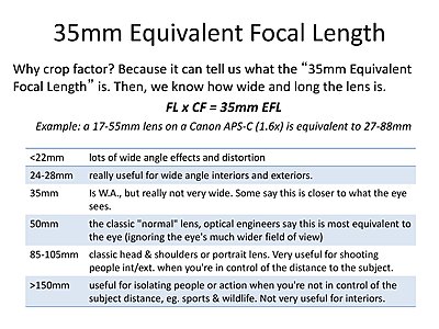

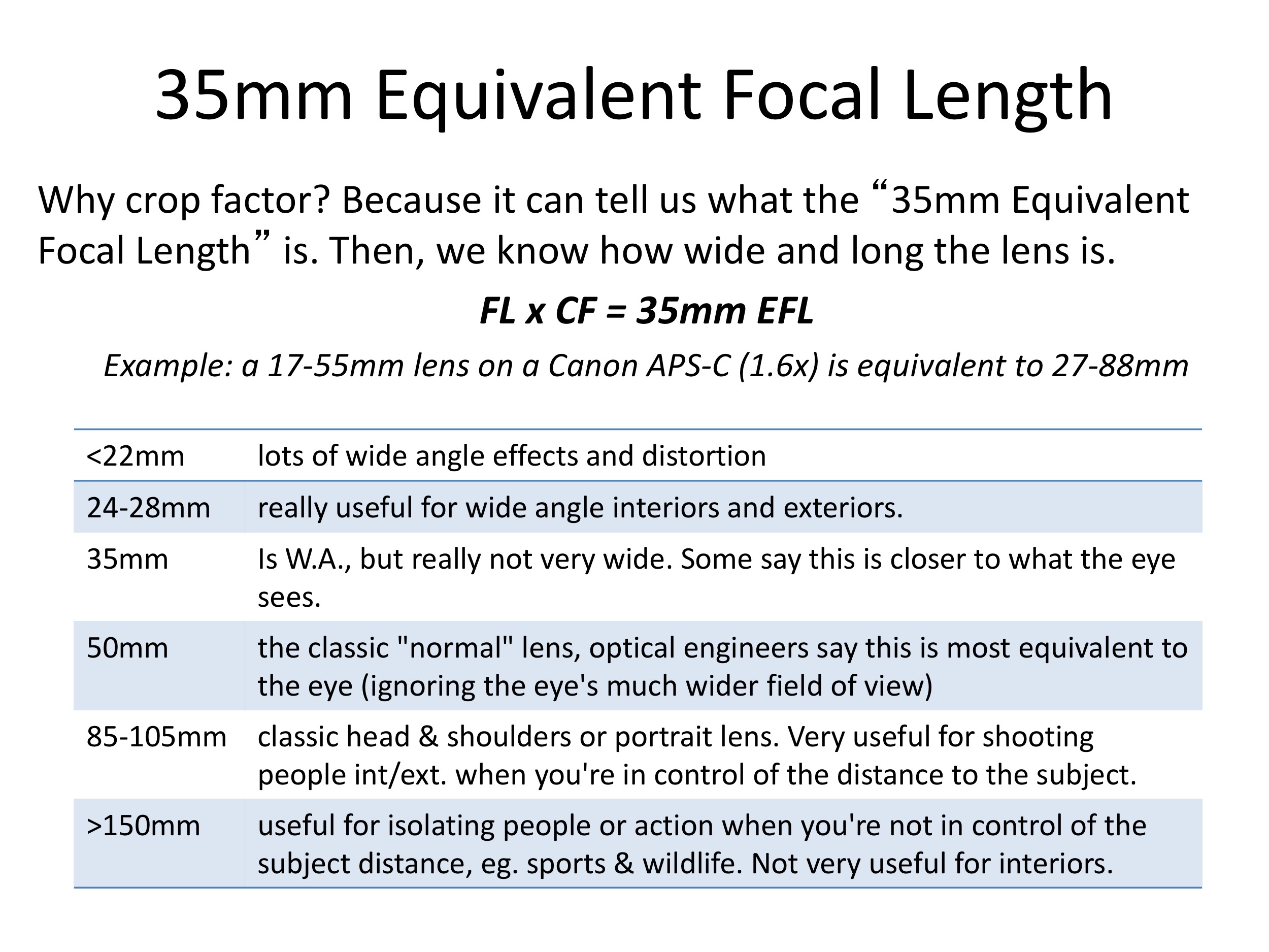

E.F.L., equivalent focal length, usually refers to 35mm EFL, that is, just how wide or tele is a shot on a crop sensor camera compared to a shot with the same focal length (or zoom lens FL setting) on a 35mm full-frame sensor.
Below is a chart I created a few years ago that has both the formula for computing EFL from a known crop factor, and, what I think of as the uses of these various equivalent focal lengths.
For more detail and math, I appreciate the work from the folks at Cambridge in Color.
Chris, while it may be helpful to directly compute EFL between various sensor sizes and focal lengths, the typical approach is to refer all EFL to 35mm full frame.
Here's a typical question: "I have a field of view I like, using a 35mm prime on a C100. My friend is bringing their Panasonic GH5, what lens should I tell them to bring?"
So, for the example above:
35mm * 1.52 (c100 crop factor) = 53mm EFL
53mm / 2 (MFT crop factor) = 27mm on an MFT. Better have your friend bring a 28mm prime.
Image circle of a lens is a bit different; it either covers a sensor without vignetting or it doesn't. It isn't related to EFL conversions, which only involve focal length and sensor size.
