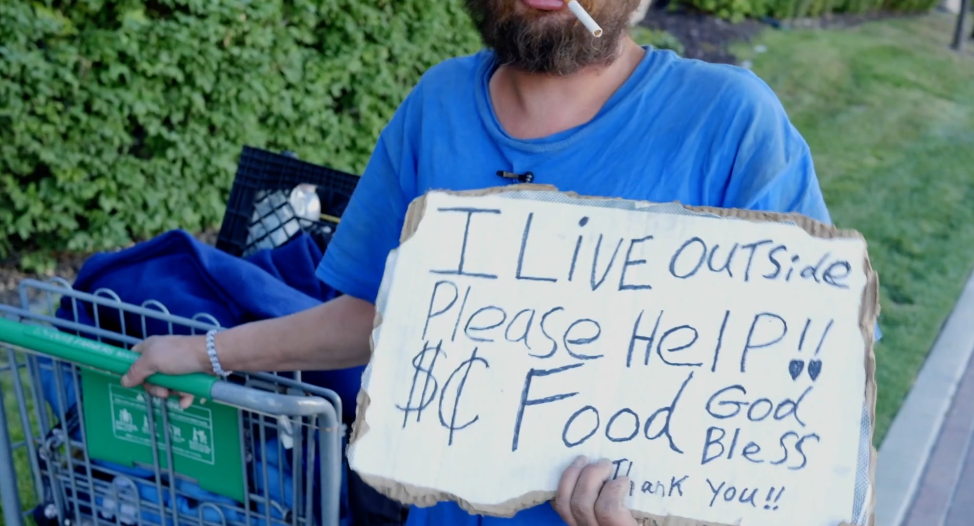

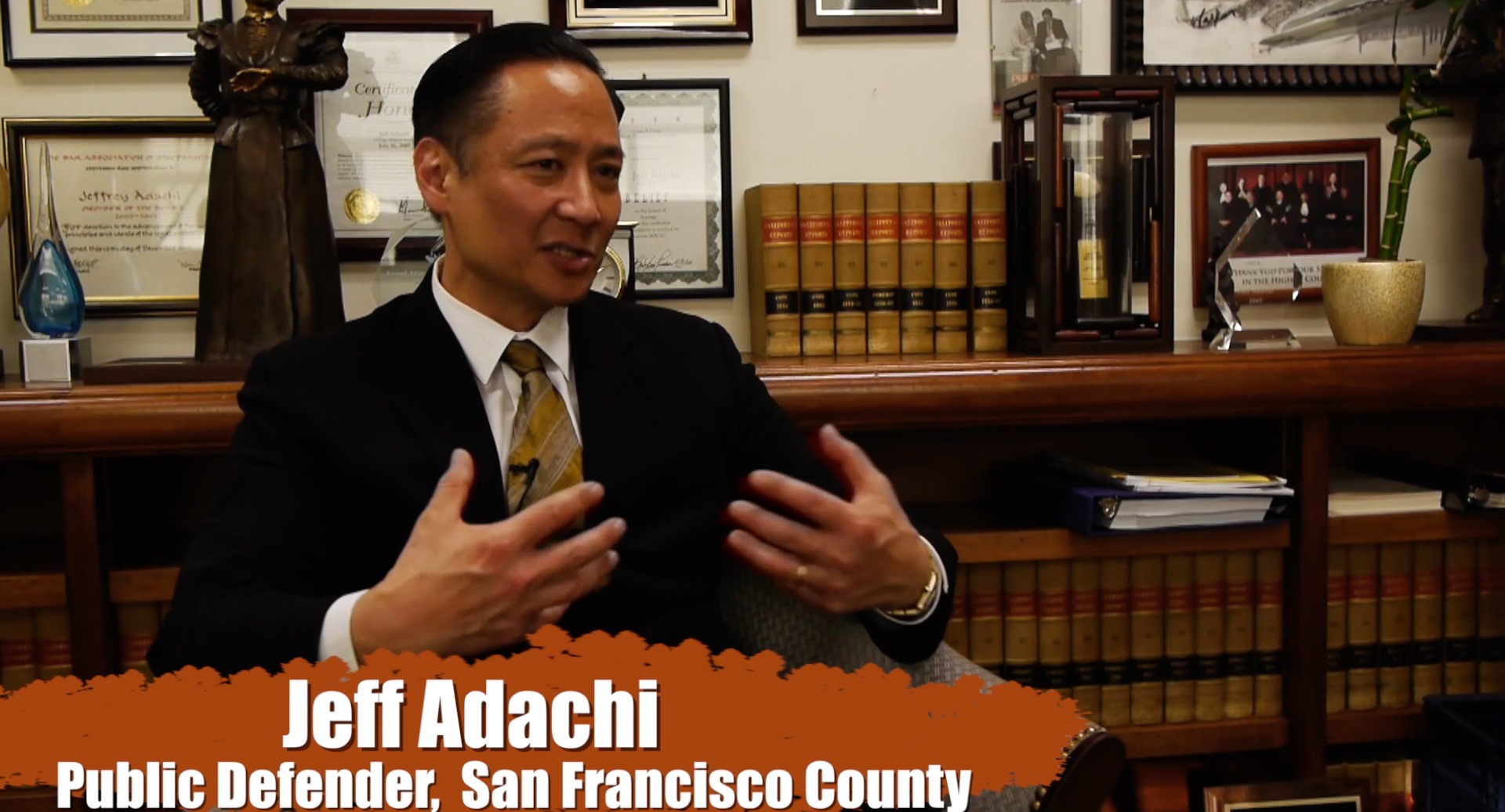

Ryan: yeah that's basically exactly what I've done (if anyone has a better solution, I'm all ears). I tried it both ways (pictured here). I created two project sequences at 1.85 resolutions to test with my source footage being 1920X1080. Below are two frames attached. When scaling the footage to 105% (to cover the pillar boxes) you have the choice of moving the frame up or down a bit if desired, but depending on how you can shoot that might cut some stuff off. In the end I realized that the best case was to not move the picture vertically so that when I scale it cuts a little bit each of the top and bottom but not a lot of only the top or bottom, however that means I'll have to adjust my lower thirds slightly as well (image 3).
1998X1080
1920X1037
DCP - Conforming 1920X1080 footage to Flat or Scope for theatrical-aspectratiiotest_1998x1080.jpg   DCP - Conforming 1920X1080 footage to Flat or Scope for theatrical-aspectratiotest_1037_withoutheightadjust.jpg
DCP - Conforming 1920X1080 footage to Flat or Scope for theatrical-lowerthirdadjustment.jpg

Yeah I reached out to a few film festivals and they also said they didn't suggest and some said they wouldn't take it with pillarboxing. No the movie is shot too tight at all that's why I decided to just do the adjustment since most guides tell you to do so, and each of the filmmakers that went theatrical I talked to also suggested it. The point about some projectionists trying to fix it and stretching the whole film is still there also. As a viewer only I'd find it a little strange but would probably get used to it, but when it's your first film going theatrical and you want to have your best showing, if it's an easy fix I don't see why one shouldn't fix it.
Only thing I really have to do is lift the lower thirds and there's a scene with burnt in subtitles as well that will have to be raised.
