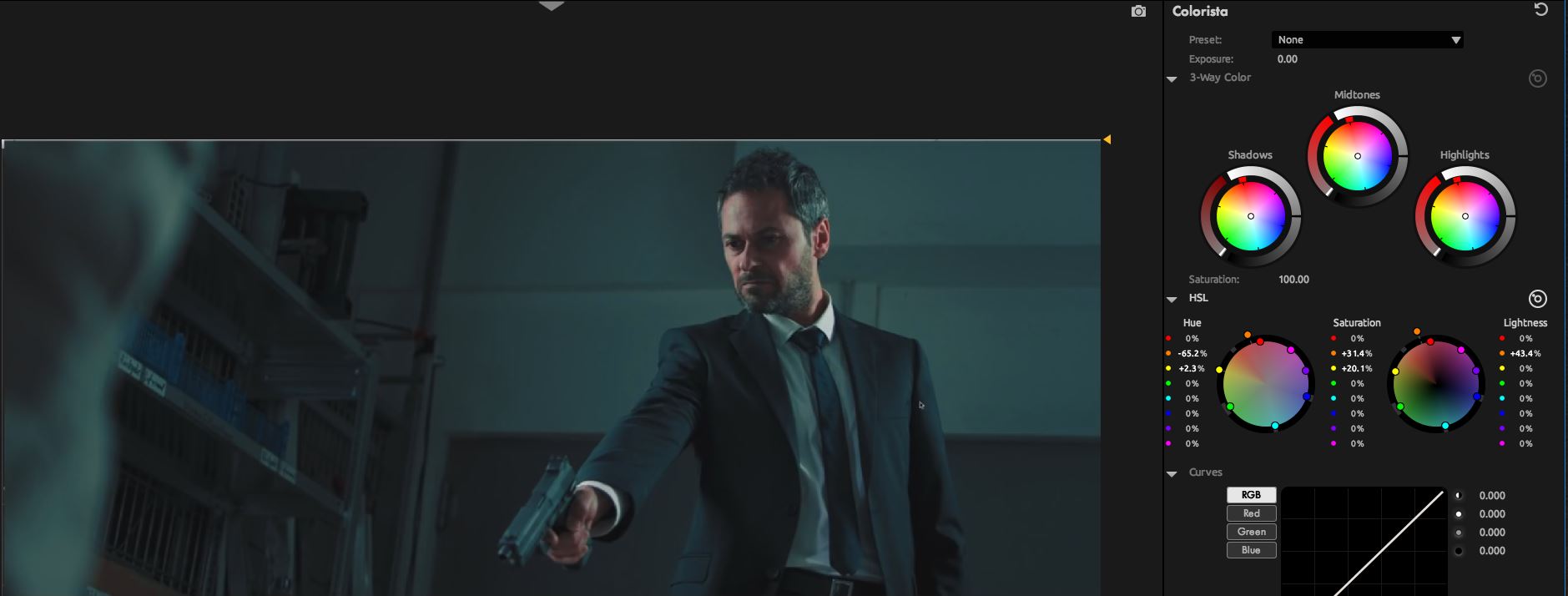

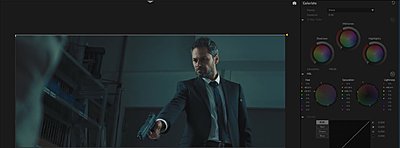

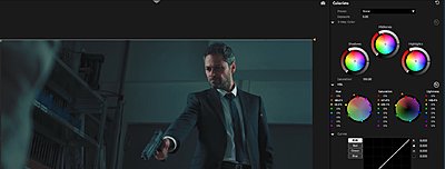

Yes given certain tools and images manipulations you can create a whole range of looks without using LUTs. The following images are taken from the clip you referred to and have not been touched in Resolve. The skin tone alone in the second image has been adjusted purely using Colorista. Obviously the YouTube image is not a great one to manipulate so the quality isn't the best but it gives you an idea what good tools can do very quickly without having to use a qualifier or mask.

As I said no LUTs involved in this example. If you look at the second picture you will see the changes to skin color have been achieved purely by selecting the skin tones and adjusting them in the Colorista control panel. The Colorista 3 and 4 way correctors are very discriminating in the manipulation of specific colors. In the second picture the 3-Way Color wheels show you that five values, 2 x Hue, 2 x Saturation and 1 x Lightness have been adjusted. That shows you exactly what the adjustment to those five values has done to the image. Now if you were to create a 3D LUT from the altered image those five values would now be embedded into your new LUT.
So what the new LUT is doing to your image totally reflects the changes you made to the skin tones and in answer to your question "...what are the luts doing to the skin specifically to do that?" is answered. The colors you changed and embedded into your new LUT are what is doing "that" to paraphrase the last part of your question.
The new LUT when applied would now apply those skin tone changes that you made and saved into your LUT to the new image... if the new image contained the skin tone values of your original image. In many ways I prefer not use LUTs and grade from the base image using the tools in Resolve and Red Giant and other OFX plugins that will work in OFX hosts such as Resolve.

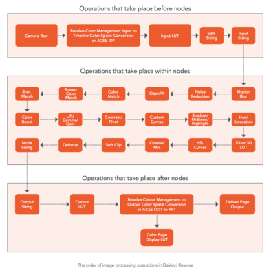

Maybe what you are attempting is beyond the tools you are using. Maybe something you are doing isn't the correct way to do it. For example Resolve has specifically recommended a particular order for grading steps to ensure best results. It's called the 'Grading Order of Operations.' serious moves away from the recommended order of steps does introduce various artifacts. With Resolve it is fairly easy is to follow these steps as they publish a chart showing them. I have never seen a grading workflow of recommended steps from any other video NLE or grading app. I'm not saying they don't exist. My experience though has been that if the Resolve grading workflow is used in other grading apps they tend to deliver the best results. Again this is a matter for exploration in your workflow using your chosen tools.

I tried Resolve from that tutorial, but perhaps I didn't do everything completely right then. However, the color noise happens right when I separate the skin tones. So is there anything you can do after that will fix it, since it's already damaged once it's done, it seems? In that order of doing things though, it does not saying anything about separating the skin color, so it won't be colored along with the rest, in those steps though.
