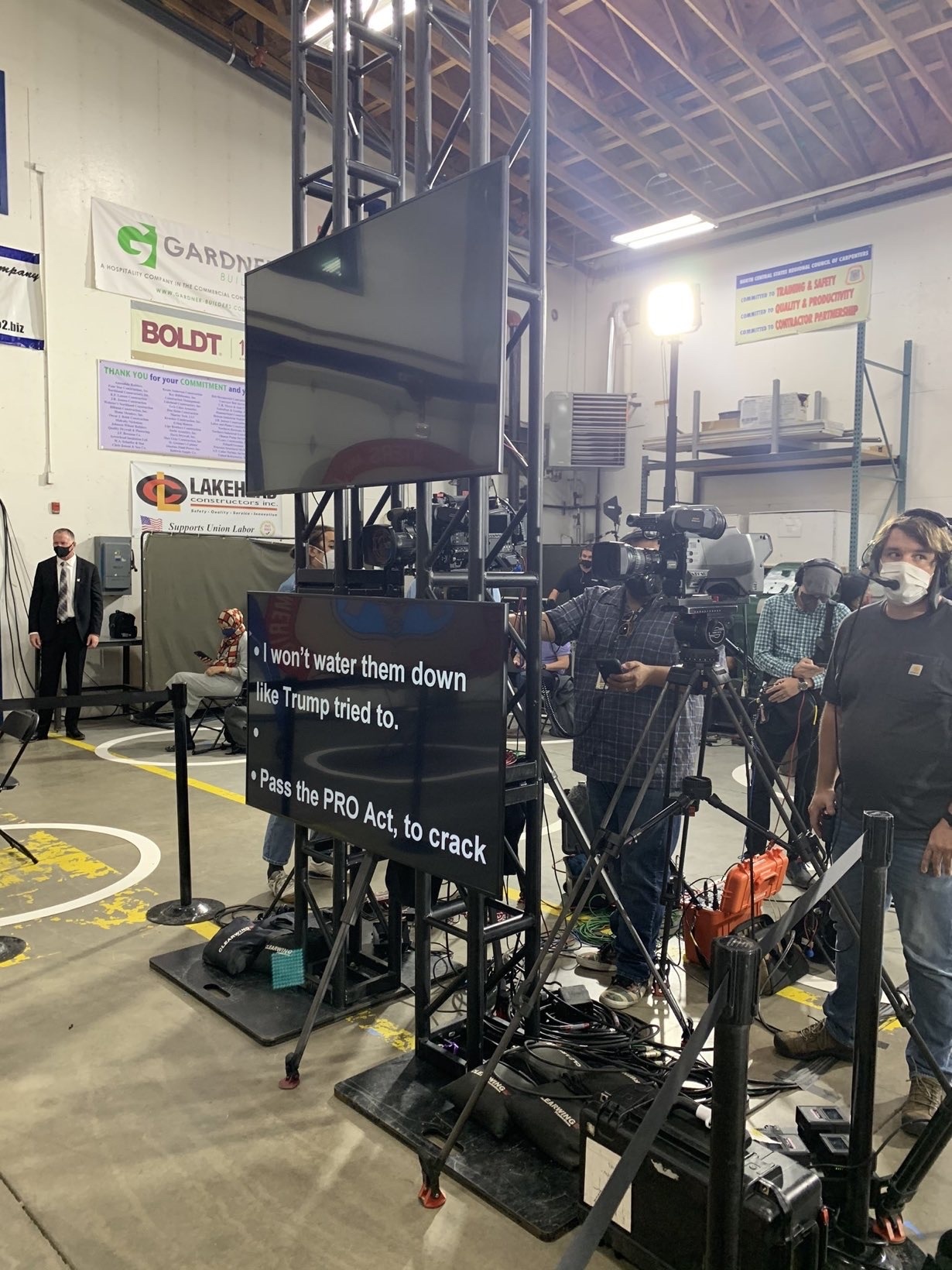

Found this pic where you have an alternate setup using large screen TV screens instead of the more complicated and expensive setup of dedicated gear incorporating a 45° glass panel.
Here (in attached photo) you can see how the line of sight for the TV camera goes right through the middle of the supports and through the vertical gap between the screens. Wouldn't be a good solution for news readers, but would easily suffice for other uses where you aren't going to be perfectly lined up anyway.
Andrew

Hi Andrew. Reading the teleprompter, it looks like a political democratic TV rally.
You’d wonder why they need large screens like that, maybe Joe Biden is way back from the camera and forgot his glasses.
And he’s in a gym, maybe in a large group? And the top screen is for location links?
Cheers.

I am actually a professional prompter operator more than I am other things, and yes for live stuff “downstage monitors” are a valid way to go. It lets the speaker move around since the viewing angles are way more generous on a large screen (they could even have 3 side by side or something, though usually in those cases middle screen has text and side screens have slides). Also good for concerts (yes I have teleprompted singers).
Ive seen screens on floor near stage angled up, as well on wall opposite stage higher up, and even once on a stand in the middle of a church aisle about 50-100 ft from stage. Personally I think the farther back you go the larger the screen needs to be, or the necessarily larger text will only allow very few words on screen at once.
That church thing was miserable because the presenters were improvising much of the time, and I could only fit about 6 words on screen at once, so it was very hard to tell when they went from improv to reading and I had basically no time to react when they did.
Possible downside is eyeline...will look like theyre looking down if monitor is on floor, etc.

I was myself thinking that for a proper teleprompter for a talent at that distance, you'd run into limitations of how big the unit could be (to have the associated height of text for the speaker to still be able to read).
Andrew

Yeah. You have to go bigger and bigger with text the further away the screen is. Also causes you to have to scroll faster to have the text keep pace with the speech.

For Sydney Town Hall, pretty large, we used 75" monitors behind and above the audience for down stage cuing for the presenters on stage. As long as their distance sight isn't a problem then it works well. Have even used rear projection and large screens for certain outdoor live events such as the footy grand finals.
Chris Young
