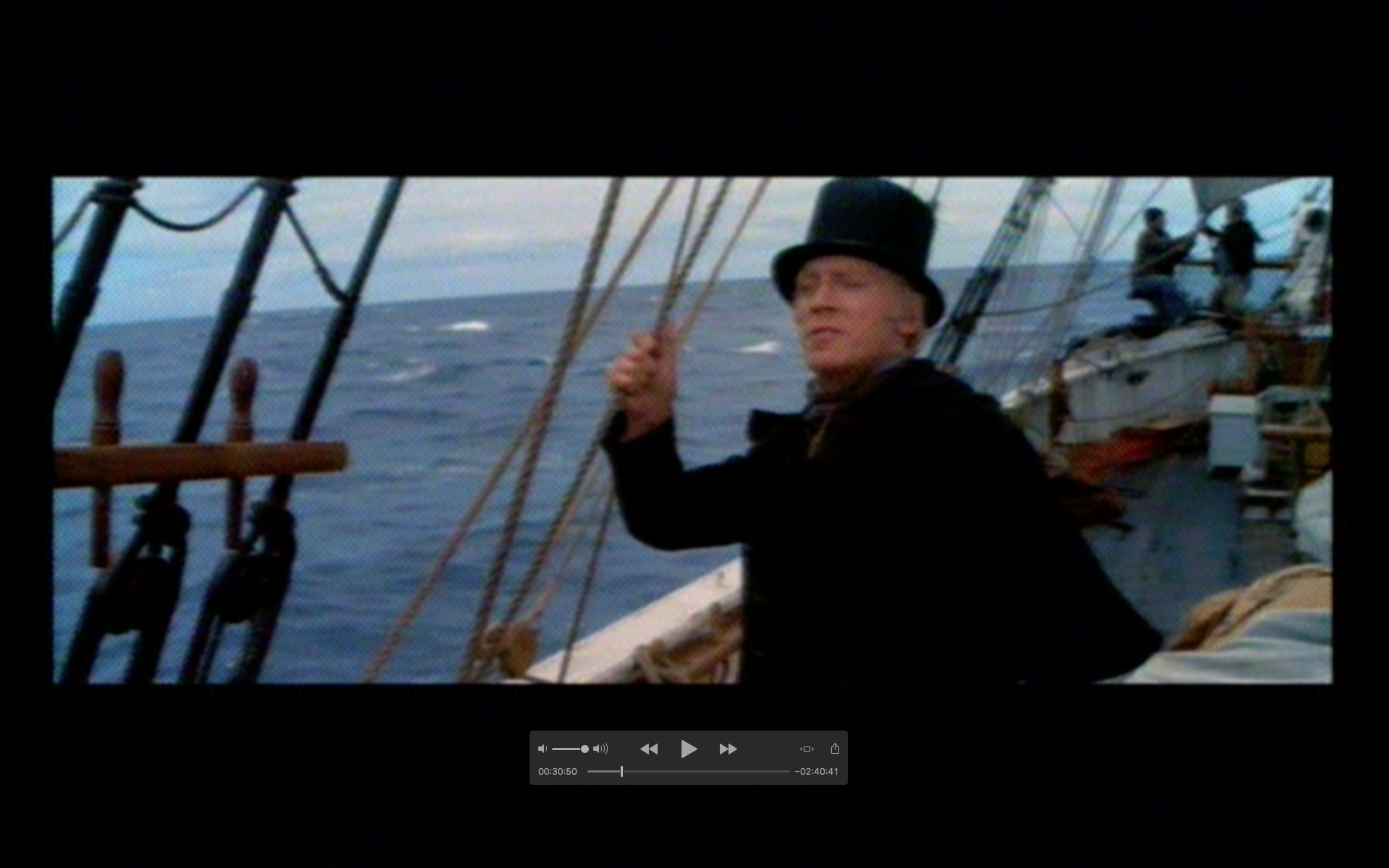

I have 3 laserdiscs that I want to transfer to DVD. My setup includes:
Panasonic LX-H670 Laserdisc Player
Miglia Director's Cut D-10 Analog to Digital Converter
Macbook Pro 2009 17" model
I've successfully captured the frames to a DV format from the Laserdiscs but they are quite poor quality.
The attachment is a frame from a "digitally restored" area.
Note the lack of definition. The frame is quite "soft".
Is this the best I can expect from a Laserdisc transfer to a DV format capture?
Gary

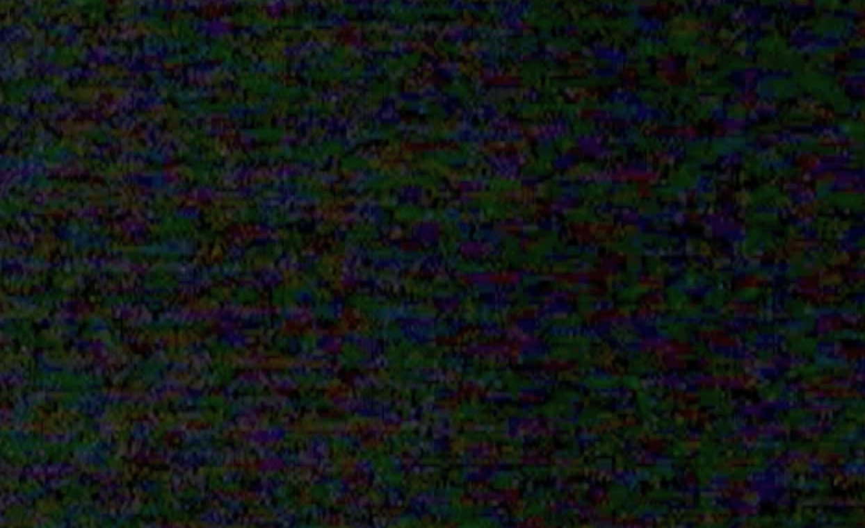

Here is another frame. It is a sample frame from a video black area. Note the large amount of noise.
For some reason I couldn't include this image in my previous message.
Gary

The snag really is just the line count. around 250 horizontal lines against the current frame size - so with 1080 pixel height 4 pixels vertically will have the same video line data on them. Worse is of course the fact the lines have a visible join between them and the next one, which registers as noise in the signal. You have the frame to frame lag as one brightness level ramps into the next, which is recorded error in the sensor used to scan the film. The blacks and whites are always squashed so all in all I doubt you will do better. You might make a small improvement to the noise and levels if you could get y/c out of the player? Not sure if this is doable? My memory says how good laserdisc was, but the same memory tells me how good VHS was too. It wasn't!

If you're not seeing similar noise just viewing the laserdisc on a TV/monitor, it's likely the converter is the culprit. Your mac is easily capable of accepting a clean, hi res signal.

I'd definitely try for a more expensive/professional converter.
The bigger thing I was going to mention is that whilst DV was a leap forward from analogue formats of the day, it's a noticeably soft format when you compare it to more modern codecs. It also has the blockyness / macro blocking (big square regions of pixels) which is likely what was showing up for you, but hard for me to know for sure.
From using Matrox products, I've often captured in their .avi wrapper mpeg2 based codec at an appropriately high data rate and it's always been a fantastic place to start.
Looking at one of my capture files for SD content per the properties panel in Media Player Classic:
Video: MMES 720x576 (4:3) 25fps 50000kbps [V: mpeg2 4:2:2, yuv422p, 720x576, 50000 kb/s]
Audio: PCM 48000Hz stereo 3072kbps [A: pcm_s32le, 48000 Hz, 2 channels, s32, 3072 kb/s]
It's plenty good for standard definition captures to throw 50Mbit/sec at the capture rate for it. You know that your acquisition isn't going to be a constraining issue in your workflow. Capture at the very best digital quality you can.
