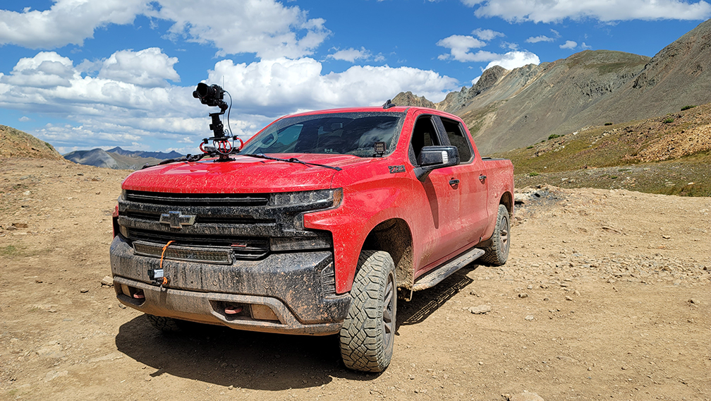

I built a stabilized vehicle camera rig. It works pretty well on paved streets at 60fps. I'm trying to get it to work when I'm off road in 4wd conditions. My Sony A7III works pretty well. I picked up an A7 IV so I can shoot 4K at 60P (cropped).

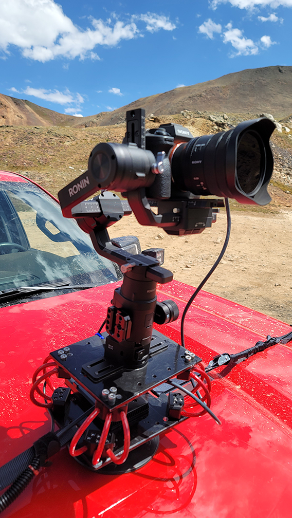

I just got back from the rocky mountains with a bunch of heartbreaking footage. The camera is mounted to the hood of my truck on a vibration dampening mount. A Ronin Stabilizer is mounted to that. The camera and Ronin are remotely controlled and monitored from inside the cab. It takes quite a beating out there but sometimes it works. At least the A7 III does.
Obviously I am dealing with a lot of motion artifacts and issues. Testing the new A7 IV and new lens has me puzzled. It did not work well. In the test clip you will see what I am questioning. Much of the footage has an overall flicker to it. Everything is shot in manual but it looks like it is searching for something. At first I chocked it up to vibration and motion and figured I was just asking too much of the system. But it is inconsistent and shows up sometimes when I'm standing still. It seems to be the worst when I am very wide and trying to keep detail in the wide vistas. My question is this flickering motion artifact or is something else causing it?
Everything is in manual except camera image stabilization is in active. Could that be the cause? I am going to try turning it off wondering if I am overwhelming it?

It could be that the three vibration dampening systems (mount, Ronin, and camera) are fighting each other. You may want to try different combinations.
I use a Sony FDR X3000 hard mounted to my Jeep and rarely get the shaking that you are getting in my off road videos. The in camera stabilization seems to do the job. An iPhone on a suction cup mount gives me the shakes. Will be trying a hard mount for the iPhone this weekend. Will also be trying my A7S iii.
