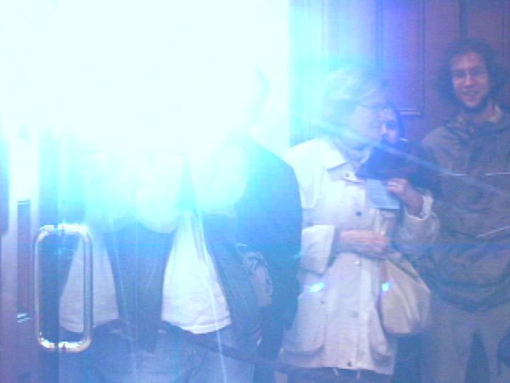

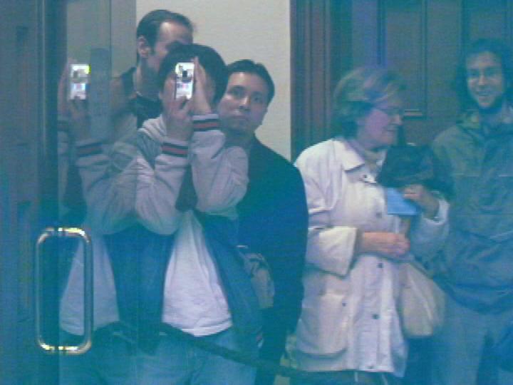

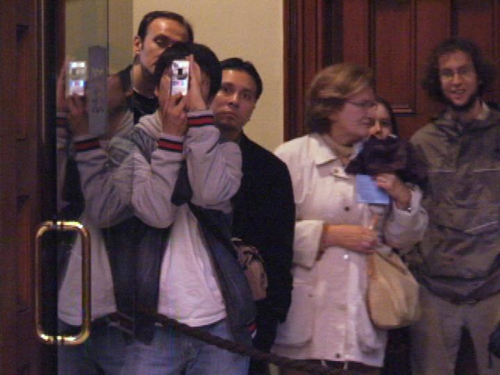

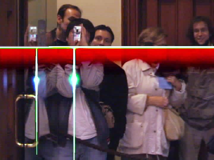

I was editing a wedding I shot a while back with a Z1. A tourist was taking a photo of the chapel. Three frames after the flash was a bizarre glitch in the frame that reminds me of some kind of electrical error. Anyone know what this is?
Shot with Z1 but in DV mode (4:3).
Frame 1 is normal. Frame 2 is camera flash. Frame three is strange glitch. Frame four is green afterglow of glitch.
Just curious,
Vito

im surprised the vertical smearing didnt hit at the point of the flash... seems to me the Flash itself was set to a slow sync and as your camera shutter was prolly running a little slower than his flash sync, the nuance you see is the after effect of the blown out exopsure across CCD.
Also, by this behaviour and looking at your frames, its seems you were running the cameras iris in manual mode or if it was set to auto, more than likely the camera was too slow to respond to the exposure and got a litl wonky as it processed the exposure readings... which is why you get those strange frames as the cam fluctuates (albeit it slowly)
I honestly cant tell if u had the cam in manual or auto.. but this phenomnenon usually happens in auto mode, BUT can also happen in manual if ur shutter is too slow...

Yeah, I was in manual mode, but the alcove where the tourist was was very dark, so I had to boost the gain a fair amount. Shutter speed was normal 60i.
Never saw this before, and I've taped billions of camera flashes, as I'm sure you have...
