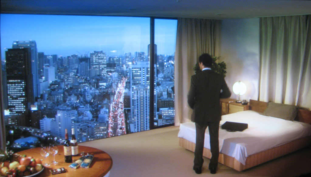

I don't have any personal experience with the new HD cameras on a big screen, but the following old thread might be of interest.
http://www.dvinfo.net/conf/showthread.php?t=14440
My experience there with the little 1/5" PDX-10 leads me to believe that HD projection would look very nice. Watching the footage from the V1 on a 36' screen at the Sony event was very impressive. They showed a clever short piece where a guy comes home to his apartment which has a spectacular view. The gag is that the "view" is actually a projection screen, and in the morning he raises it up to reveal a messy little yard piled full of junk with no view at all. I didn't feel that it had a "video" look at all and the detail in the background image was terrific. Here's a photo I took of the screen.
