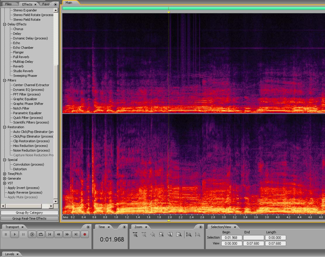

so if you're only shooting with the camera's audio, whenever clipping happens, what would you do ? correct it with audio tools like adobe audition ?
that's what I'm doing currently and I feel that it's taking me too much time with my DVX and this clipping happens very often . I'm using internal mic for ambient and XLR mic Rode NTG-1 shotgun. Clipping happens on both the channels.
I'm intending to take the plunge to HMC.. but don't wanna do this kind of lengthy audio editing .

can you briefly describe how do you setup your shot, and some possible reasons why you are not having any clippings ?
My type of clipping / distortion problems with DVX :
=http://www.d7weddings.com/download/Temp.wav
