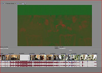

Some of my footage from the 150 has a plaid-like distortion, and other sections has just a solid color, no images.

Images from HMC150 footage
Here are some screenshots taken from the preview window in Vegas of the HMC 150 footage. Footage is from a wedding, indoors. On the timeline when playing the phenomenon appears as dropouts. Some sections are jerky and very weird and things jump.

I downloaded the footage a second time....it is the same.
Update: I played it back on-camera and it appears fine.
I downloaded the footage via usb cable, and the same thing is happening. The footage on some clips jumps: People in the scene who are walking appear to take a step backwards and then move on very jerky, but only on some clips. The "dropped frames" appear only here and there, but it's pretty bad.
I am running a i7 processor on a very stable PC.

Hi
Have you tried to view it somewhere else than Vegas 9, that I guess is the NLE you use?
How about the Panasonic AVCCAM viewer, have you tried that?
/Ulf

No Ulf, I haven't tried that.
I am onto something though, and I will report back. I think I have found the problem.

Clips view fine in the viewer. This issue is Vegas related I think. The clips render out fine also. I need to install my old version of Vegas and try that.

Are these the raw mts files you're opening in Vegas? They can always look a bit strange when I do that, so I have to transcode them with Neo Scene. The resulting avi's look fine.

D.R., it turned out it is Vegas 9 issue.
I installed Vegas 8 and the files playback properly much better now.
Thanks to everyone for your input.
