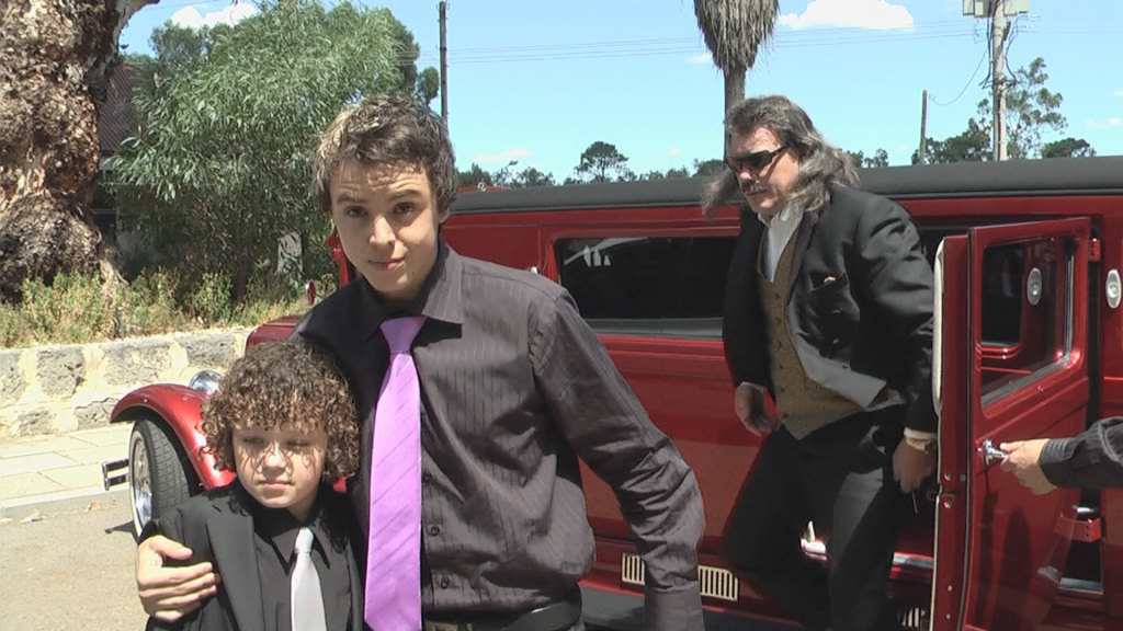

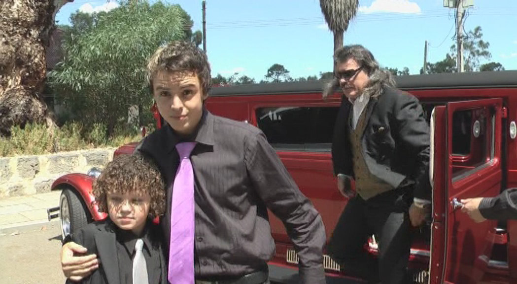

I was busy editing a wedding so I did a quick still from the AVCHD clip and then the transcoded footage and much the same place in the track. I made both images 1024x576 and de-interlaced them and then compressed them 20% so they are not too big to upload.
Is this your concern??? If you look at the guy's tie it has lost detail so there IS softening but is yours much the same or worse????
I just figure that by dropping from HD to SD you HAVE to get some loss but although it's clear on a still it's not so pronounced once the HD footage is rendered to MPEG2.
Chris

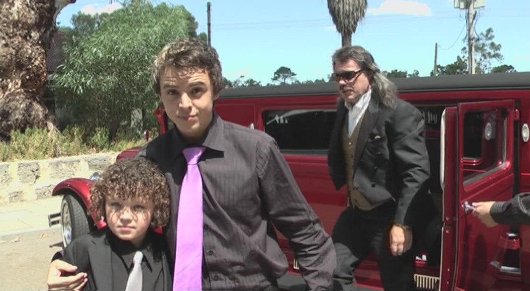

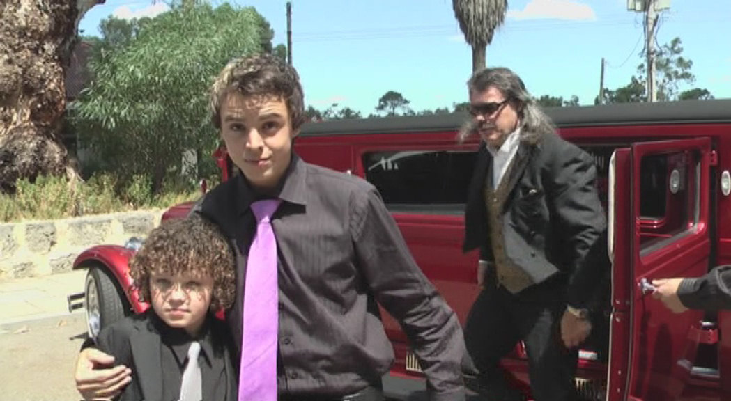

Final Test for you is an MPEG2 render of roughly the same piece of footage the first rendered from SD AVI to MPEG2 and the second from 1440x1080i AVCHD to MPEG2 and a still frame was taken from each piece of the now SD MPEG2 footage. I really and truelt cannot see an awful amount of difference once it's rendered????
Chris
