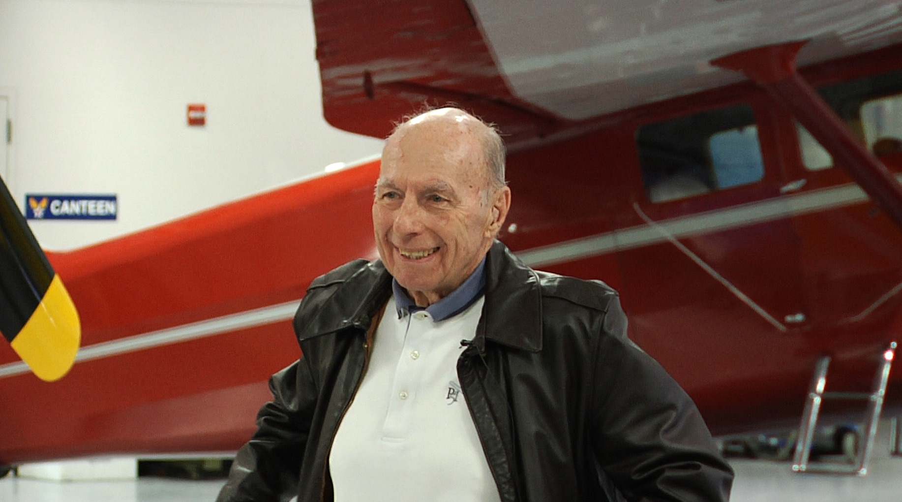

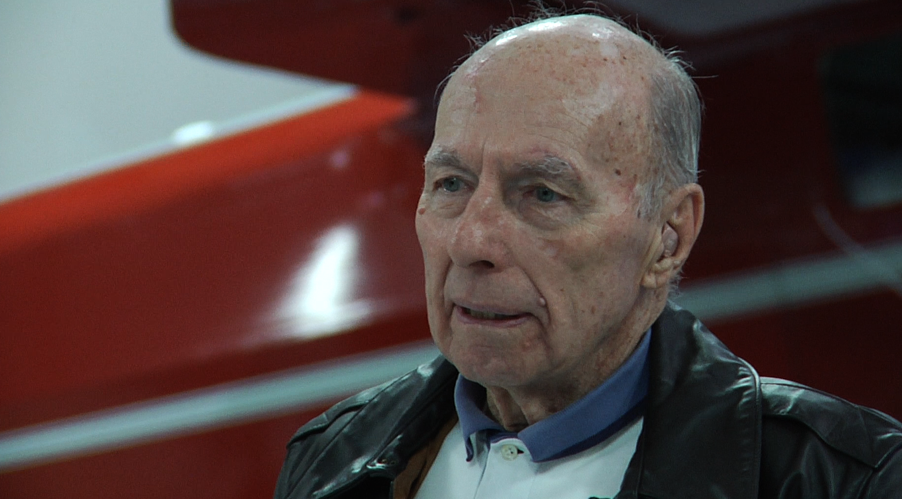

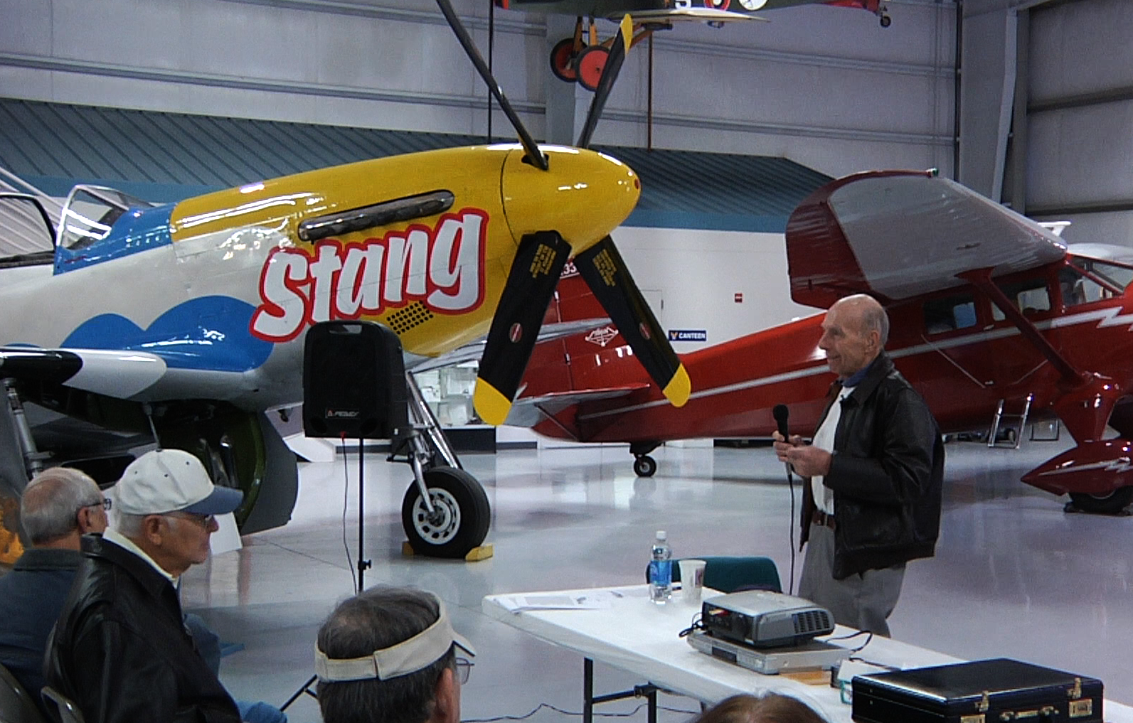

Color shift with zoom
Shot this weekend at a hanger which had halogen lights and skylights. When I started to go through the footage, noticed that when I zoomed in all the way, the color shifted...zoom back and the color went back to original. I also noticed some color shifting when it was stationary but attributed that to the partly cloudy day. Lighting was changing in the hangar.
It's most apparent with the skin tones.
Could this be a problem with the camera or the fact I have a Tiffen UV filter mounted? Or am I missing something else?
Attached are untouched stills from the QT Pro Res file.
Color shift with zoom-screen-shot-2010-01-25-1.07.19-pm.png   Color shift with zoom-screen-shot-2010-01-25-1.07.40-pm.png

Auto Tracking White Balance or from a white card?
If auto, well, it just doesn't work well all the time.
If you did a white, you didn't do it where the guy's face was? Or the combination of light changed from the time you did the white?

WB from a card right where he was standing! full manual on camera. Another friend came up with the white balance as a possible source of the issue. It is possible I missed the button or something dumb. It wan't hard to fix in post but I will be playing with the camera tonight to make sure everything works!

Looks like as you're zooming you are losing quite a bit of your ambient lighting. It looks slightly under-exposed. Was the exposure on automatic? Try putting it on manual iris, and open it up a few stops next time if you can.
I do not believe from this, that the cam is defective--this has happened to me before too. When it does, I just zoom out slightly and keep shooting. Then I can zoom it in slightly in post, if need be.
When that route does not work, (I use Premiere Pro CS4) I go into Video Effects....Adjust....Shadow and Highlight, and fix it there. I am sure other NLE's have a similar feature.

thanks Steve. I was on manual iris and that's why I'm a bit baffled. I was full open for most of this shoot. Think the UV filter could be cause?
It was no problem in FCP to fix but a bit annoying. This is the first time I've seen this and the only major difference from the other shoots I've done was I was purposely far from the subject so I could get a good DOF look which worked great. The filter has been on the lens from day one so that's a constant. I'm gonna play with it tomorrow and get to the bottom of this.

Did another shoot today and had no issues...must have "dumb-thumbed" a setting on the air museum shoot! SO....a big WHEW!!! Me...not the camera!

The HMC40's lens has a maximum aperture that varies as you zoom. Max aperture at full wide is f/1.8, max aperture at full telephoto is f/2.8, so if you start zoomed out with the iris fully open, then zoom in all the way, you should expect to lose one and a third stops of light.
Not sure if this explains the color shift, but if you had the gain locked down this is probably why you were seeing the exposure change that Steve noted.
I believe (someone please correct me if I'm wrong), the solution for the exposure issue would be to manually set the iris to f/2.8 or higher and then set gain/shutter speed for proper exposure, which should then be consistent across the zoom range.

I'm solidly behind Mike on this one - it's simply the fact that the full tele shot is under-exposed compared to the wide shot (look at his shirt whiteness / brightness).
It's not the UV filter Robert. It's the fact that you haven't let the gain compensate for the lens ramping, the loss of lens speed (you say you were on full manual).
I think the next shoot (where you didn't meet this problem) was possibly in a better lit place? In which case your full wide and full tele could have been shot at f/4, say, and all would have been well.
