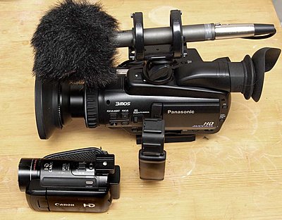

I have an HMC40 and an HF10 (predecessor of the HFS100) - I love them both and use them both! The main difference is simply the form factor - particularly if you want to hang stuff off the camera (the HMC40 in the photo below has a 0.7X adapter and hood, light bracket, tripod plate, and external mic). Also the control rings and user buttons allow you to change manual settings fairly easily while recording on the HMC - the HF has a good selection of manual settings but they are 'fiddly' to access at the best of times. (The HFS is a bit improved I believe). The HMC is heavier, easier to grip, and consequently easier to keep stable when hand-held.
The HMC has slightly better resolution - but both cameras are great in that respect! The HMC also does slightly better in low light - the cameras are equally bright but the HF's grain is a little worse. Low light is not a strong point of either camera. The HF10 footage suffers from chroma interlace artifacts unless you are careful with what software you process it with - its NOT inherent to the camera, but is tricky to avoid. (Not sure if this persists with the HFS100).
The HMC's viewfinder is bad, in my opinion - I rarely use it. But it is there if you need it.
The HF is uber-portable. The HMC has a degree of 'pro credibility' that, to be honest, I find useful for some of the work I do with it. Obviously which of those has greater weight will be a very individual thing.
Basically, if you don't need a larger form factor, or a viewfinder, and don't need 720P60, then the Canon is going to save you a $1000 or so.

Graham thanks for your input and particularly for the photo. I never realized that the HMC-40 was so much bigger than the consumer stuff. As a matter of fact, in my case, the smaller is the better. I'll probably go with the smaller camera. I consider the Panasonic TM-300 as well.
