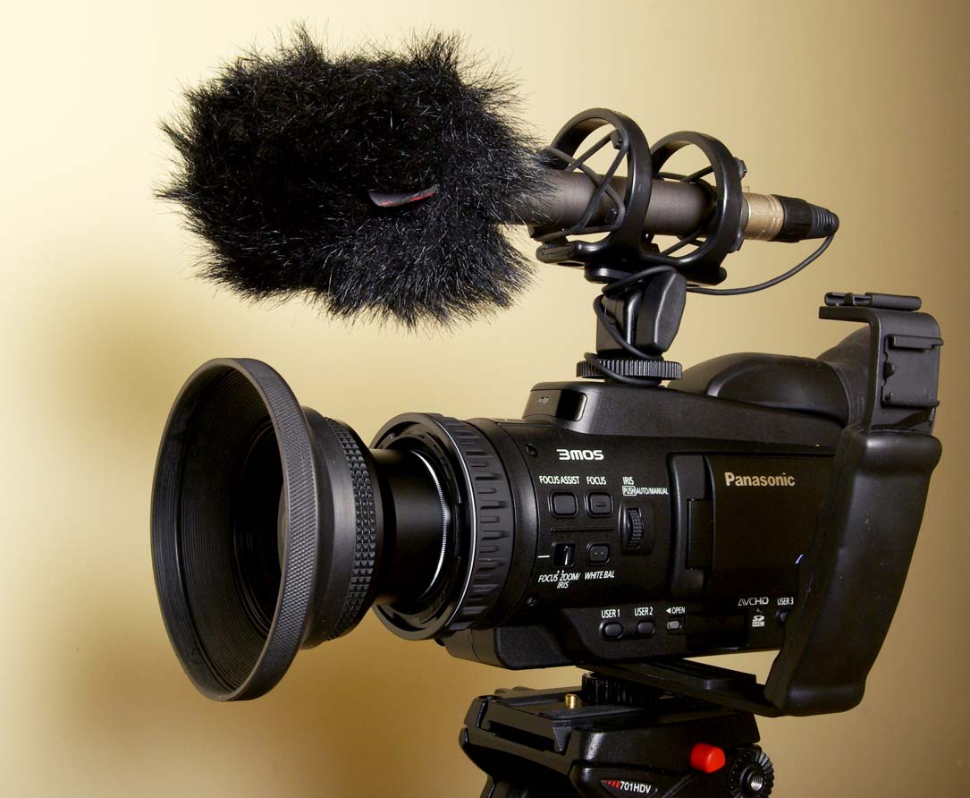

To give you an idea of size, here's my HMC40 with a Panasonic 0.7X adapter and $3 rubber lens hood.

Thank you for the feedback. Looks like I might as well stick to my trusty HVX172 then. From your photo, my original purpose of getting a HMC41 is definitely lost. It is not any smaller than my HVX172 in that case (after attaching the lens hood on the 0.7X adapter).
