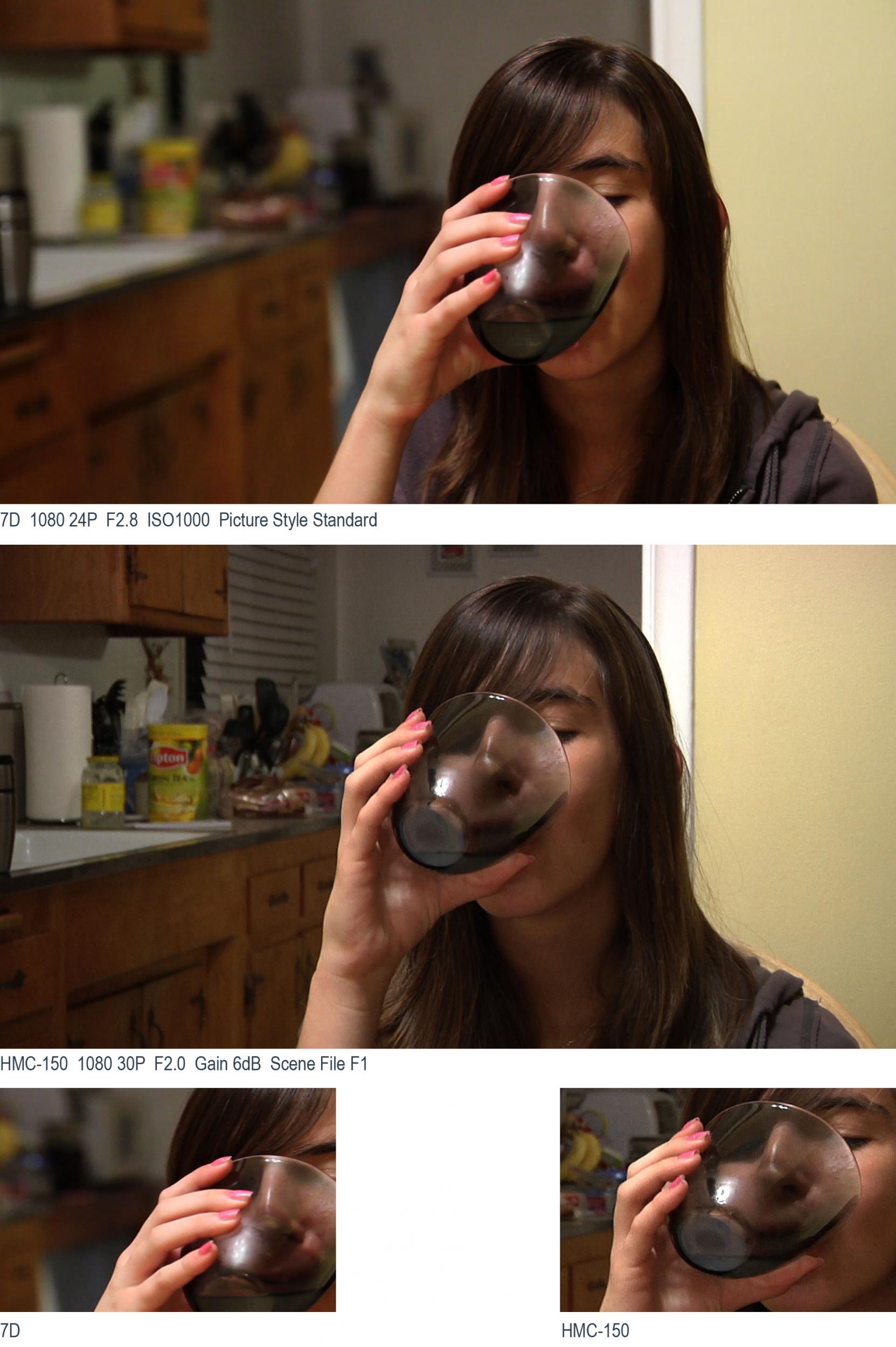

I purchased the HMC150 last year and I was never satisfied with the image I was getting. In November I purchased the Canon EOS 7D to use primarily for stills. When I experimented with the movie side of the 7D I was really impressed. This is the image I thought the HMC150 was going to give me. I'm not talking about the shallow dof here (I expected quite a difference in that area), but what I am talking about is the difference in video noise/artifacts. The HMC150 always looked blotchy, grainy, and just flat-out bad. I love the camera feature-wise, but I also want to love it picture-wise.
I am including a frame grab from each camera. There is no lighting (save for the natural light in the house) - I just asked my daughter to pose while I shot with both cameras. As you can see, my poor HMC150 failed to get close to the 7D in terms of image quality.
Is there something I should be doing to give me a cleaner image out of the HMC150? Thanks.

What is the process you are using to create the HMC150 screen grabs?

I converted both movies to Apple ProRes 422 within Final Cut Pro. Next, I opened both of the converted files with MPEG Streamclip and exported both stills from there.

well, first off...apples and oranges with the two cameras and you will always be disappointed comparing them. I was happy with the 150 til I got my T2i. BUT mixing the footage works just fine for most of the stuff I deliver which is web 720 30p. I acquire in 1080 30p on both. I've done 5 shoots in the last couple of weeks with both cams and they are serving me well.
First thing I noticed was you have a +6 gain on the 150 which will be noisy. You have a very fast lens on the 7D which enhances the 7D's low light prowess.
Second, 1/3" CCD's vs. REALLY BIG CMOS.
One thing that I noticed with my 150 that you may want to try is setting the black balance. Seems to affect the noise in a positive way. I generally will set white balance and then set the black. Manual says to do it whenever you switch modes or if it hasn't been done in a while.

Well, coming from the DV world, I guess I had expected the image from the HMC150 to at least equal the quality I was getting from both the Sony DSR-500, and the Canon GL-2 I was using as my B-Camera.
I create a 3-screen show with an image size of 2160x480. For presentation purposes, I split that image into 3 720x480 movies, which are then output to 3 DVDs and shown using 3 projectors onto 3 screens. I wanted to go HD because I could almost get a full screen image (I scale it to around 110% to fill) when imported into my 2160x480 sequence. But when I got what I wanted, the HD image of the 150 looked bad next to the other (smaller) DV stuff going on around it. I had to deliberately stylize the footage each time to make it look like I intended it to be that way.
Putting an image in the timeline from the 7D was a vast improvement. I was just surprised at the image of the 150 even when compared to other DV formats.
Also: I did set the black and white balance on the 150 before shooting the test.

Apple ProPres doesn't get along well with AVCHD video. I had a corporate project last year that was almost ruined because the client's in house staff were using Final Cut, and it was severely degrading the original image quality during the ProRes injest. I had to redo part of the edit in Sony Vegas Pro in order to show them what it should have looked like, which convinced my client to hire another editor to finish the project. ( since then, I've heard that the CineForm Neo Scene CODEC for Mac can fix this problem )
I don't know if ProRes is the main cause of the problem you are seeing, but your footage looks kind of rough compared to what I am used to.
Some people are using Adobe Premiere CS4 for the Mac, because it's one of the few Mac editors that can work with native AVCHD files without transcoding. ( I use Sony Vegas Pro under Windows Vista 64 which also works with native AVCHD files )

Everything can look great until you have something to compare it to. If ProRes was doing it's job, then your footage should look at least as good as when you play it directly from the camera over an HDMI connection.
Cineform Neo Scene is a 10-bit CODEC that is designed not to degrade over many generations. I haven't used it with the Mac, but I think you may have to use the Cineform software to injest the video in order to bypass the problems that ProRes creates. ( this is how it is done under Windows, and fortunately the Cineform software does batches of files )

There is a big difference in the settings you used. In the HMC150īs image there is heavy sharpening! In my oinion that looks bad most of the time.
Try that: in the scene file menu set the "detail level" to -7 , "v detail level" to -7 and "detail coring" to + 4

I can see the hmc resolving more detail then the 7d, just look at the hair but also the skin were the 7d appears to have a more uniform color and doesn't show much detail either. But one could argue about the fact how that will look from a distance, while everybody screams for more and more detail the 7d proves that by blurring details a bit it appears much smoother and sharper. For weddings brides will be happy not to notice those skin imperfections that ex1/3 type of camera's will gladly show off :)
