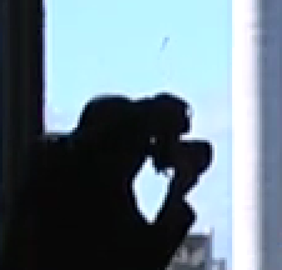

Sharpening?
Thanks for posting this -- it made my day.
Do you have any example footage with sharpening turned off? The current setting seems fairly heavy, particularly with the hard silhouettes. Detail in the model's hair seems to hold up remarkably well, though.

nope. we had 5 hours with the camera, that was it.
sharpening was set to 0 from memory.
