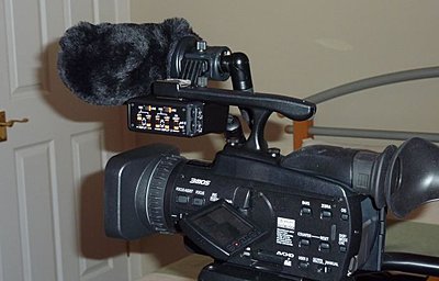

Couple of things. For audio, I have the AG-MYA30G XLR Adapter and use an Audio Technical AT875R shotgun mic or a Rode NTG-1.
How does this help? Well, I only use one mic, normally. I know the purists say you have to get the mic within feet of the subject, but a great big noisy steam train can be heard more than a few feet away! So I use the XLR unit and switch it to feed the mic into both both channels, left and right. I can then use the level dials to have left and right channels at different levels.
So the left audio channel is recording at a lower level than the right channel. I can then choose which track I want to use in post, or even blend the two together, so if the right channel clips when the train is close and loud, the left channel is at a much lower level, and is not clipped.
I hope that makes sense! It works for me. I'll admit it involves spending money, which may not be what you want to hear, and there maybe a way to do it with the Rode Videomic, but I've never used it. If anything, I would suggest having the level generally low to boost it in post. Also check out the mic attentuation switches on the Videomic which may help you limit clipping.

The XLR unit came either free or at a bargain price here in the UK. As a stopgap, you may be able to plug the Rode Videomic (via their simple adapter) into one channel and use the XLR unit as you would with an XLR shotgun.
Adapter here: RØDE Microphones - VXLR
Failing that, you could sell the videomic. The AT875R mic is very popular amongst HMC owners due to its small size, excellent performance and relatively low cost. I've added a Rycote windshield to mine, as steam trains always seem to appear on windy days here!
Update: attached a (not very good) photo of the set-up. Boy do I need to clean my camera!
