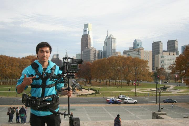

I would NOT suggest attempting to fly the AF100 on anything besides a true tiffen steadicam.
Also, if you're planning on using a Voigtländer, you're going to need to use some sort of wireless follow focus because there's no way you're going to be able to keep focus and maintain a smooth shot using a tradition follow focus.
I've attached a picture of my rig. It's an AF100, Voigtländer 25mm .95, and Varizoom WFF kit, mounted to a pair of generic rods, all sitting on an old Steadicam Flyer.
You get what you paid for, and that's especially true when dealing with steadicam-look-a-likes. Definitely look around for a tiffen workshop. They're a ton of fun and you get to fly your camera for free! Plus they show you how to properly put on the vest/arm/camera.

Nice pic Kevin--can't mistake the Art Museum steps (probably the most famous Steadicam location of all time, made famous by the Rocky movies). Did you take a run up with the rig? I never did it myself but I hear the depth of the steps make it a little challenging...
