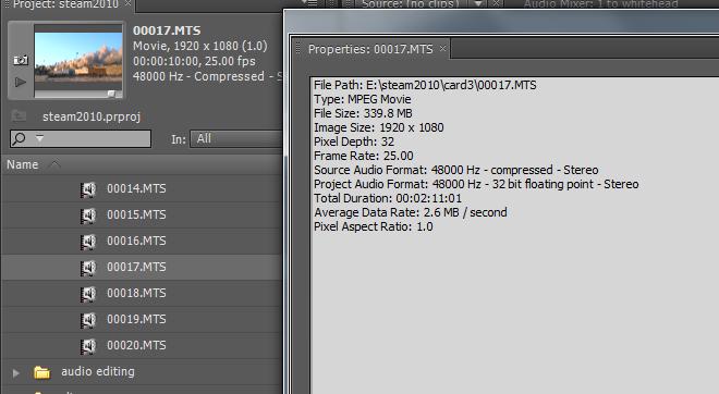

Hey Chris,
I just checked this out to make sure, it is indeed 1920x1080 when shooting 50i, with a PAR of 1. See attachment for proof, I had to make sure I wasn't dreaming it!
(Edit: this is of course form the HMC41, just for reference)

Thanks Mike
I had to ask someone as I suddenly saw the 1920x1080 on my preview monitor.
Darn!! That means that in Sony Vegas the encoder will actually do a poorer job rendering to SD than with the HDV file ..the 1.333 PAR and the PAL SD PAR are reasonably close but now there is a HUGE difference.
I'd love to find a decent solution to get pristine DVD's without lots of effort!!!! I actually transcode the MTS file to M2t HDV using NewBlue Upshift so my little DuoCore can handle the files BUT it still keeps them as 1920x1080 square pixels!!!
The confirmation is much appreciated
Chris
