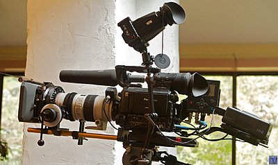

Here is the setup. Looks great except the Iris controller does not work on the EF lens. This is the second lens I tried.
I am sure RR will sort this out for me. I just hope it is soon, I was going to use it on a shoot tomorrow. Oh well. I have waited this long.

OK thing look a little better this AM.
I got an email from RR this AM and they asked for some photos and info. I supplied this.
I then did some further testing and found that the problem is a bad ground in the wire or the Hirose connector. I do get 9.3v at one of the pins but the ground is not working, so by jumping a ground to the Hirose sleeve I got the unit to work right. So I need a replacement power unit, or I may re-solder / replace the cable. This is up to RedRock when they get back to me again. I am also hoping that the Live lens can be used with power from a D-tap. More on this later.
One point of interest is when the power to the LiveLens is turned off the lens opens up all the way. So at least with my 70-200 f2.8L IS turning the power off to save battery would not work.
Other than this rough start I really like the MFT LiveLens. It is small and easy to work, it shows the Iris in 1/3 stops. and the adapter seems very well made. I will shoot some tests later when the power issue is solved. Bad cables are not a new thing to us in this industry, it may even be that it left RedRock in fine shape, sometimes a cable is defective or a solder joint just is weak and fails. I must have had dozens of XLR's and BNC cables as well as others go bad over the years.

I now have repaired the Hirose plug, the negative wire was broken in the cable where the brass strain relief is crimped on.
The LiveLens now works perfectly. I really like it.
RedRock TechSupp called me twice this morning and they are shipping me a new battery power unit overnight. So I would say this is very good customer support. The issue was resolved quickly and I did get to talk to a human, twice even. They are also letting me keep the original setup so I can shoot today and tomorrow, naturally it is now raining.
And they told me that it is fine to use an AB or IDX battery plate with a D-tap as a power source. This is great I will convert this cable to a D-tap, so I now have one battery that runs the AF100, Nanoflash, LiveLens, Zakuto EVF, and an on camera LED light if I like.
