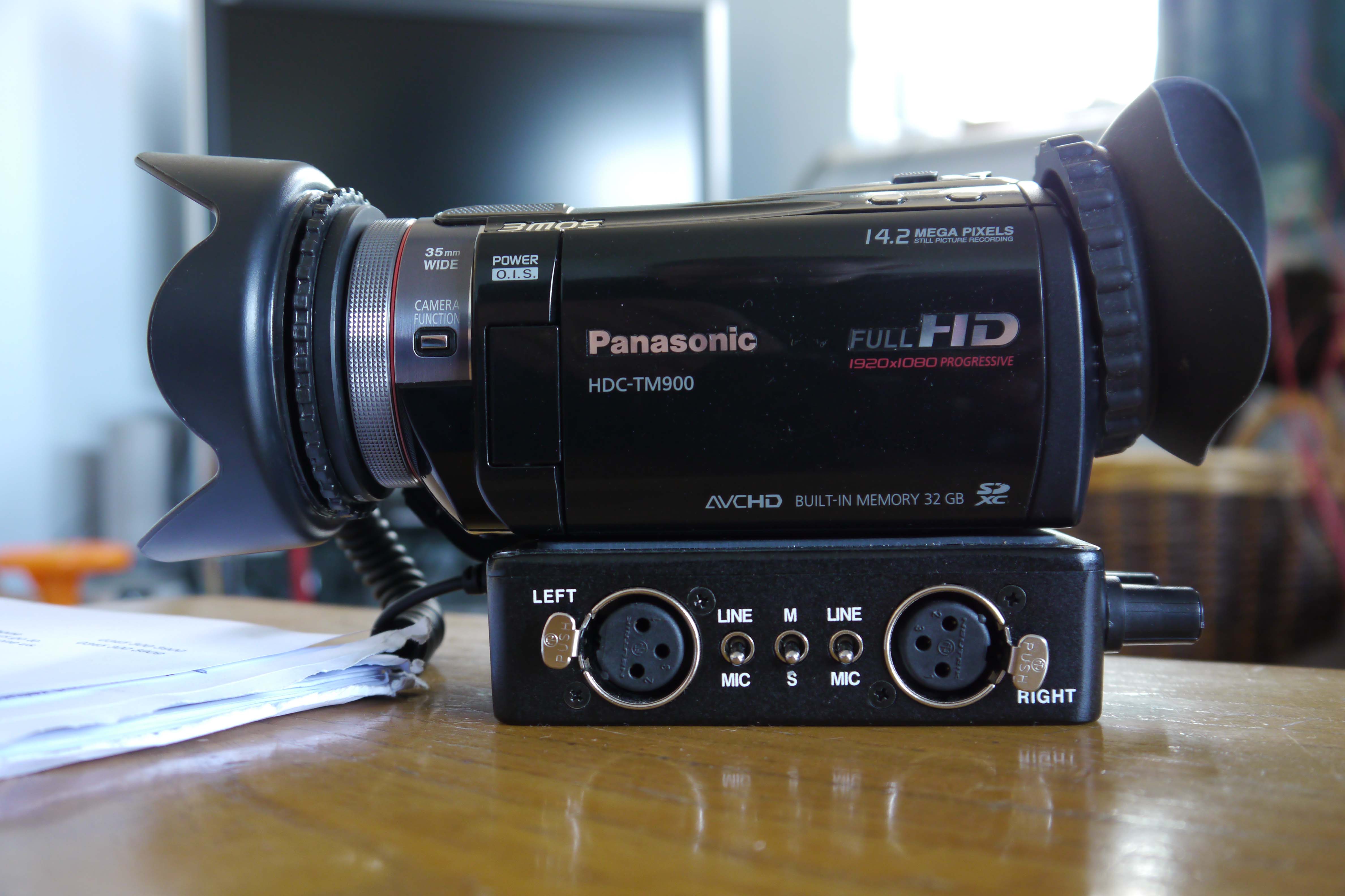

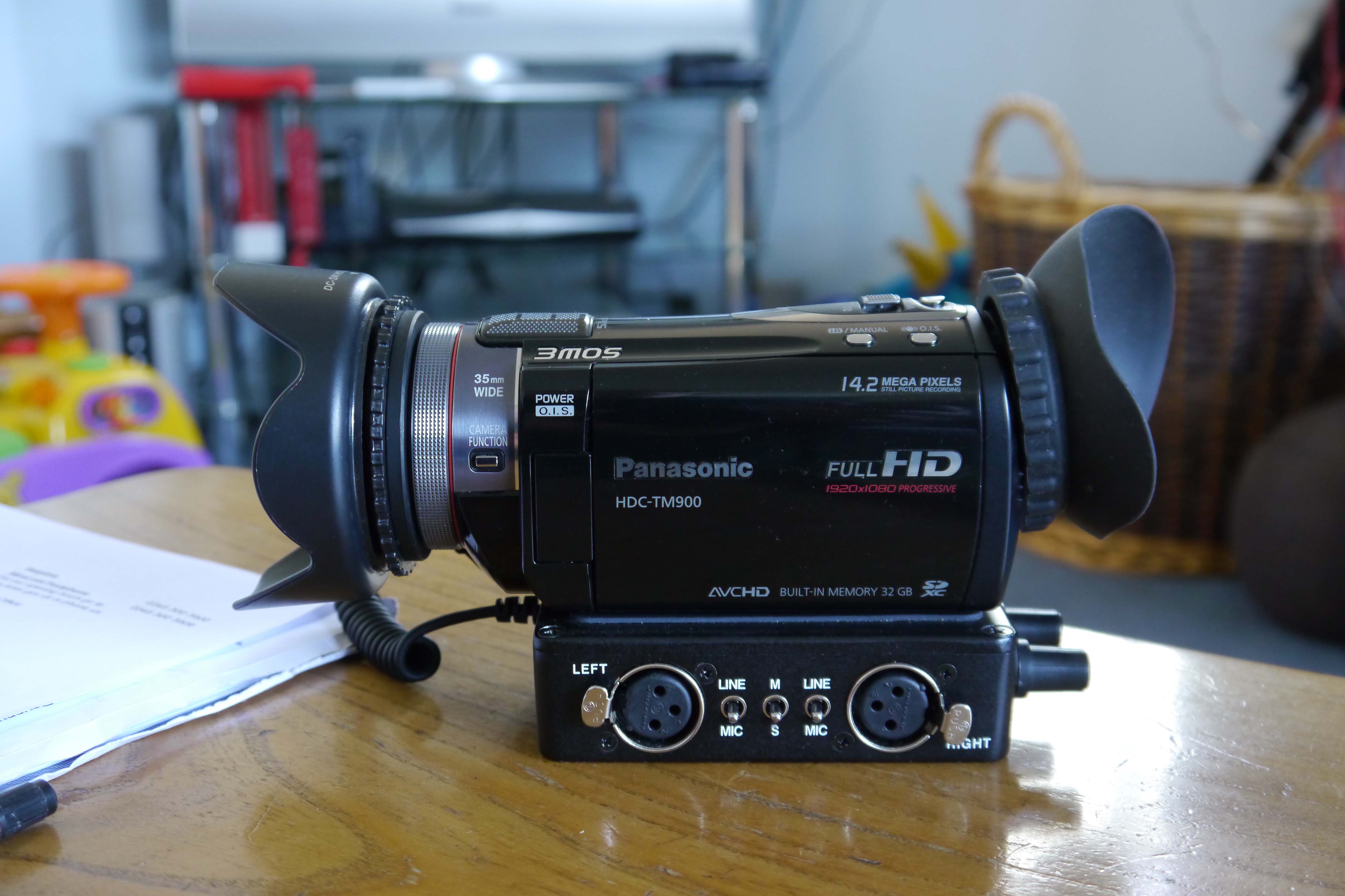

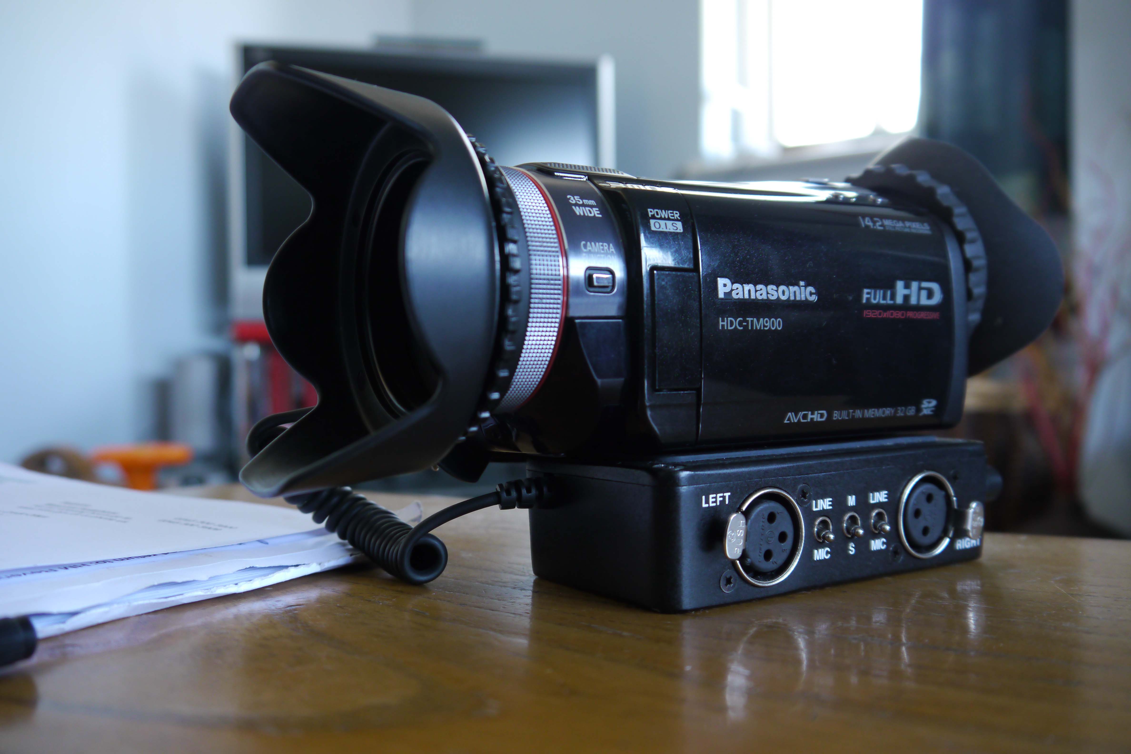

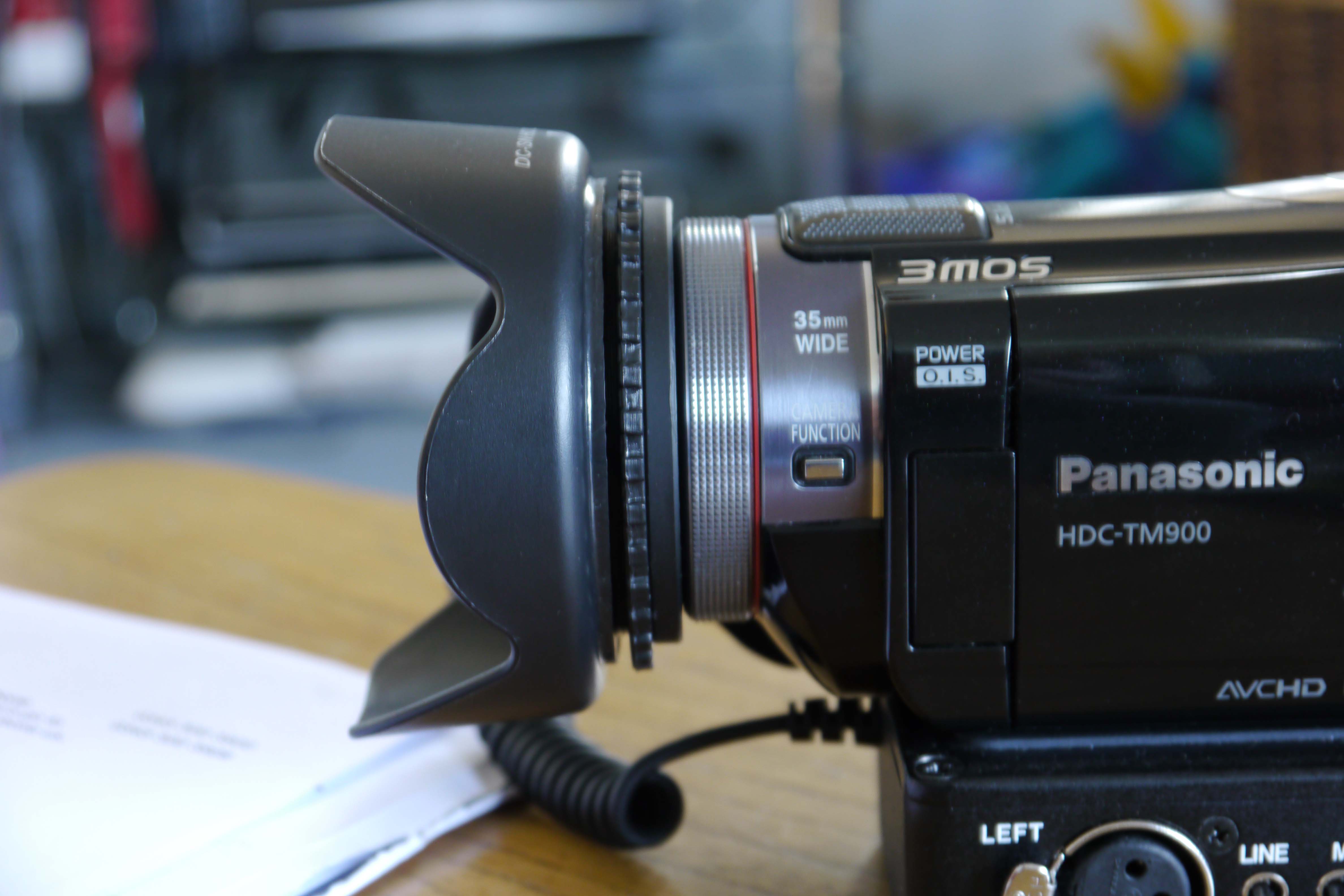

I put this together on my TM900 for just a few pounds. Go for a 46 to 58 step up ring, this will make sure there is no problem when panning quickly with the OIS active. Also a petal hood eliminates any chance of vignetting in general.

Thank you very much for the replies.
ALastair,
A bag over the camera is certainly in the works.
Colin,
Love your setup. Wish I could use one of those eyepieces too, but I'll have an extended battery on mine. Is it flexible rubber?
EDIT: So how does a filter and hood combo work? Filter attaches to camera and hood screws on to filter? I've never used one before. What brand petal hood is that?

Old March 8th, 2012, 07:02 AM   #7
Location: Cornwall UK
Posts: 793
Re: tm900 at 100mph filter and hood possible?
The rubber eyepiece is very flexible, it just slips over the rear eyepiece of the camera. I only use standard batteries, but I guess it could be adapted for use with larger batteries.
Lens>step up ring>filter>Lens hood. You will need a large filter, ie 58mm so that the OIS does not interfere with it when panning.
I dont know the make of the lens hood, got it off e-bay, there are dozens on there. The hood and 46 to 58 step up ring cost about £6

I'm trying to find an eyecup that slips over and has the side skirt kinda like yours. Not having much luck. Any ideas?

It came off a Seagull LCD VF. The hole is just snug enough to fit over the widest part of the EVF. Unfortunately, I have not been able to track one down that can be purchased on its own. It is certainly a big help on bright sunny days.

Colin - what kind of XLR adapter is that, a BeachTek? Does it have phantom power? Looks like it fits the TM900 perfectly.

Bill- It is a Beachtek DXA-4, no phantom power. it does fit the TM900 perfectly. I have had it for a few years, purchased for use with the FX1 I had at that time, so glad I didnt sell it. I believe Beachtek produced a model, DXA-6A that provideded phantom power via a 9v battery. It was about the same size, and the fixing screw was positioned about the same place. It is now discontinued, but may be worth checking out on e-bay
