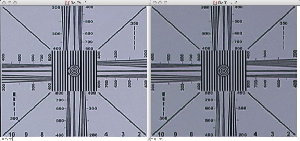

I exported these images from FCP as tiffs and then zoomed 200% to make the differences easier to see.
The one on the left is live the one on the right was taped. The quality of the diagonal lines is interesting - less combing effect.
