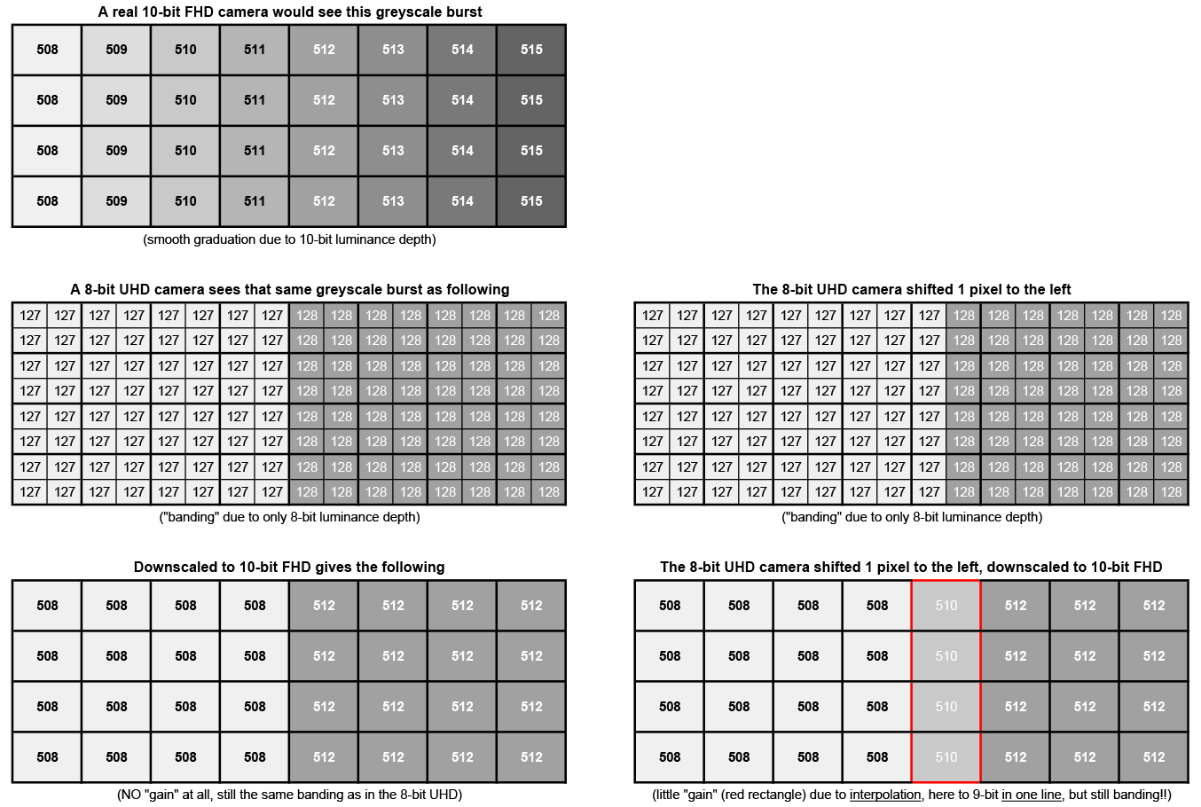

V-LOG is best at 10-bit, but not from 10-bit UHD to 8-bit FHD
Barry, why this wrong and confusing "10-bit UHD becomes 8-bit FHD" here?!
http://pro-av.panasonic.net/en/dvx4k...ef_vol1_en.pdf
Is that what you "think" or what Panasonic made from it?! No 8-bit camera can seperate intensity information to the degree of a 10-bit camera, even not after downscaling! Some of your points are not wrong, but there is no "10-bit" benefit in this "method"!
Where a 10-bit camera kicks in is in smooth transitions that can lead to banding, especially after grading. Banding only becomes visible in areas >> larger than single pixel distances. This 8- to 10-bit theory only is "noisy" "may happen" statistics and only is "true" for little pixel to pixel/neighboured distances.
Example:
On a real 10-bit FHD camera a grey ramp (horizontal line/block) could look like: 508-509-510-511-512
An 8-bit UHD camera sees this as: 127.127-127.127-128.128-128.128-128.128 (twice as much samples due to twice the horizontal resolution, but coarse 8-bit values).
Downscaled this to 10-bit FHD becomes: 508-508-512-512-512 (get it? There is NO benefit at all!!! The “steps” are as coarse as in 8-bit, there is no more information as in 8-bit!)
8-bit UHD camera shifted one pixel to the left: 127.127-127.127-127.128-128.128-128.128
Downscaled to 10-bit FHD becomes: 508-508-510-512-512 (Here the maximum, only statistical benefit appears, a “gain” to 9-bit between two pixels, but not to the whole horizontal ramp!).
The described 8- to 10-bit benefit has nothing to do with a 10-bit recording!
V-LOG would benefit from real 10-bit, not from this downscaling theory!

Sorry Joachim, but as I explained before completely wrong. You "may" gain an increase in bit depth in pixel neighbour areas (2x2 matrix), but when larger areas are covered by one plain color followed by another area in the "next" color or intensity (e.g. 127, next 128), there is no way to get something between these two colors in post!!! You still get the same banding as in the 8-bit data!!
This 8-bit to 10-bit is only a may be statitics in pixel near pixel areas.

Originally Posted by Roland Schulz View Post
Example:
There's nothing wrong in what I wrote; the difference in what you're describing and what I'm describing is that you're limiting your example to a pristine mathematical gradient and therefore limiting the sampling to strictly horizontal, whereas I was using a 2x2 matrix and the assumption that we would never be shooting something that is absolutely as defined as perfectly resolved gray in perfect lines. When using 2x2, as shown in the article, more shades are possible for each pixel. And those shades will be captured during the downconversion, and will be properly represented and stored in the 10-bit recording.
But if you add another line below it, thus filling out the matrix to 2x2 rather than 2x1, you'll create the potential for not only that 9th bit, but also a tenth bit. Which is exactly what I was saying.
Of course it does. The summation of the pixel data retains the differences between the sampled pixels, and recording it at 10 bits allows a wide enough data pipe to record those retained differences.

Everything correct here, but the benefit for 8-bit UHD to 10-bit FHD is zero zero since "banding" is HARDLY visible in neighboured pixels, it is visible on "slow" graduations, and there this "8 becomes 10-bit" theory has hardly any effect.
Telling 8-bit UHD becomes 10-bit FHD is simply misleading!! It is only based on statistics, not on image information nor technology!!
Even worse, this method can act as a low pass filter!!
I made a sheet to show what happens in this table:
