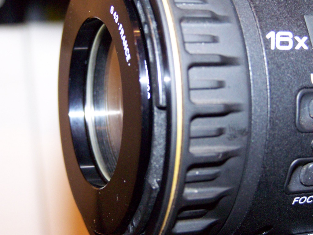

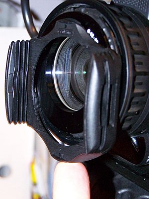

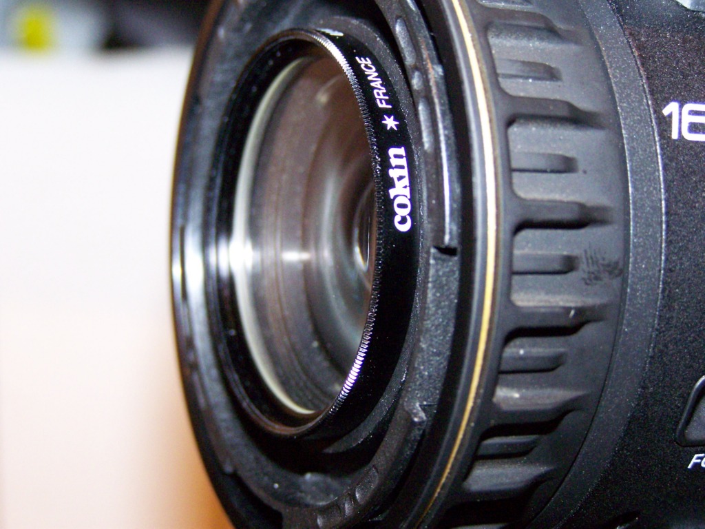

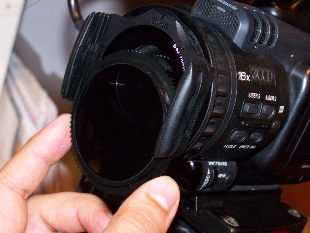

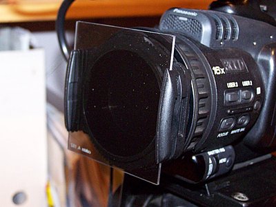

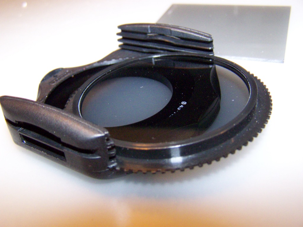

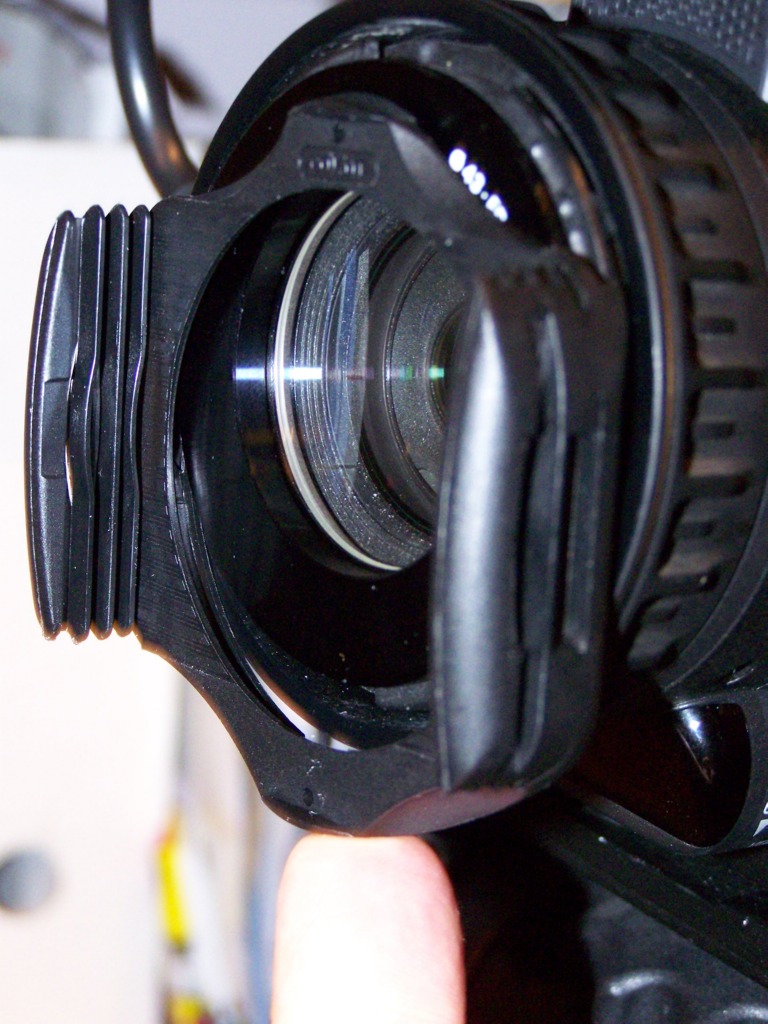

check this out
Cokin has a integrated filter system wich is a possible solution.
I have a 43mm UV always on and the DVC30 hood can be attached also upon this. When I remove the stock lens-hood I use the 43mm cokin ring and next the
A series filter holder where you can mount 4 filters.
The only problem I'm facing is when I try to rotate the polarizer my fingers are messing with the camera's ring (but using an extention ring will extend the gap between them.
Another thing is that they have an extra lens-hood (wich I've ordered)
I got all these 5 parts (UV-ring-filter holder-polarizer-ND) for 70something euros here in Greece. With the use of another ring w/ the desirable diameter you can use everything with another camcorder or digital camera.

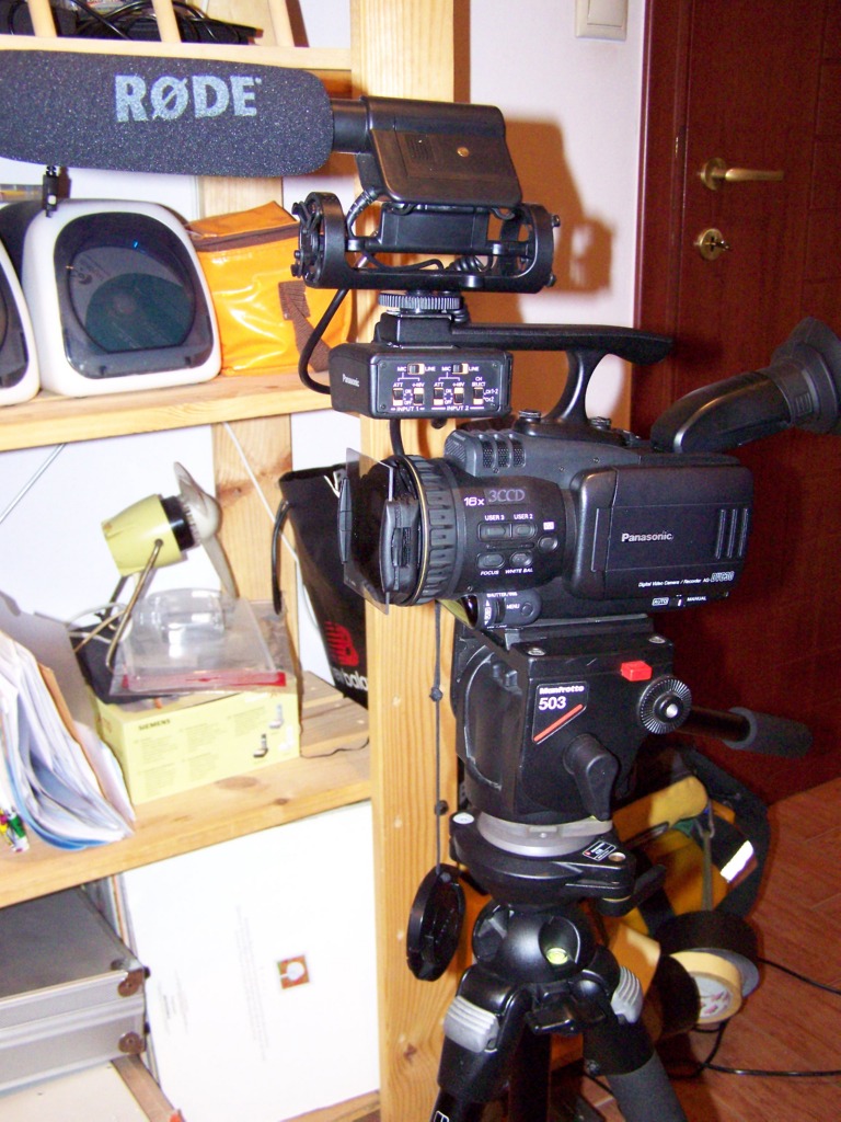

sample-photos
here are some photos too...
Confusing AG-DVC30 Filter Size Question-100_1658.jpg   Confusing AG-DVC30 Filter Size Question-100_1659.jpg
Confusing AG-DVC30 Filter Size Question-100_1660.jpg   Confusing AG-DVC30 Filter Size Question-100_1662.jpg
Confusing AG-DVC30 Filter Size Question-100_1664.jpg   Confusing AG-DVC30 Filter Size Question-100_1665.jpg
Confusing AG-DVC30 Filter Size Question-100_1666.jpg   Confusing AG-DVC30 Filter Size Question-100_1670.jpg

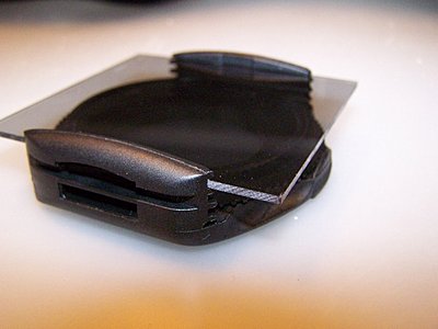

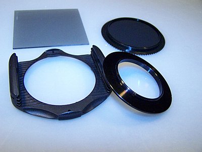

and a few more
and a few more

here's what I've got for the dvc30:
-43mm UV filter (always on - it also helps to screw the next element of the system)
-43mm adaptor ring for the A series
-"A series" Cokin filter holder
-"A series" circular polarizer
-ND A152 (2X)
-and Cokin A255 modular hood (two pieces which are fit together as one)
these are the exact models for each element.
but if you own or planning to have a camera with bigger lens diameter, put an adaptor ring 43 to 58mm, say, between the UV and the Cokin Ring and then go for the P series.
