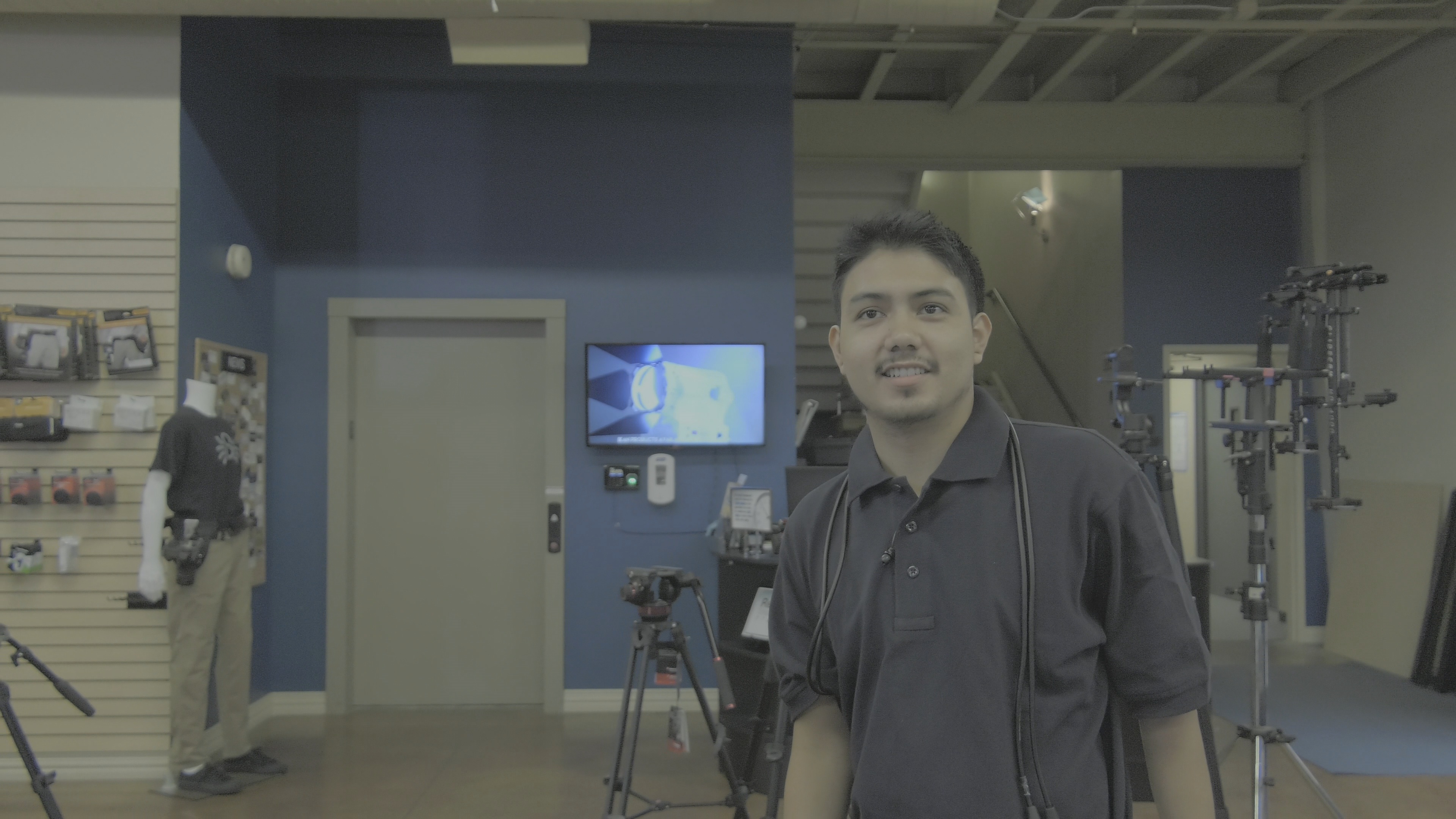

Originally Posted by Zach Hunter View Post
I have to agree with you. The same issue was present on my HMC-150 and AF100 (although not near as bad). I very much liked the look I got from the Cine-like D gamma, and if you exposed correctly, you could get a decent image with it. However, especially when shooting indoors, the noise in the shadow areas made the image practically useless, even at 0db gain! I would always end up using Cine-V or B-press, and I hated the punchy, overly contrasted "video look" I got from those gammas, but for the sake of controlling noise, I had no choice. I'm not saying these cameras were bad by any means, but having to change the scene file solely for noise compensation could become a bit of a hassle. What I want to know is, what happened to the original Cine-Like gamma curve that was available on the DVX100? It was the perfect compromise between noise and contrast, and still gave you a relatively cinematic look. Then when the HVX came out, it was gone, and we were left with only Cine-D and Cine-V, no in-between! Maybe it has something to do with the gamma standards of High Definition or something. I just hope this shadow noise problem is fixed on the DVX200, I really want to be able to make use of the V-Log L curve.
I had a chance to shoot some footage on an Engineering model using V-log the footage looked good on the monitor but when I imported it to my editing suite there was noise in the shadows. I hope this will be better on the production model. I plan to rent and test before I buy. I attached a screen capture
Has anyone Filmed with a production model in V-log?
